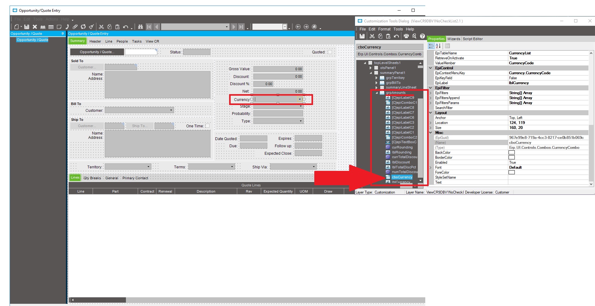

When I try to move an element out of one group box to another in customization mode, the element disappears when I drag it outside of the GrpBox it is assigned to, and doesn’t re-appear where I am trying to drag it to.
Example: Quote entry > Header, I am trying to move the cboCurrency element out of GrpAmts and over to another group box but it disappears when I drag it.

You can select the control, click edit - cut and then highlight the new group and select paste.
You could hide the original control. Create a new one on your customization and replicate the EpiBinding setting from the original control.
