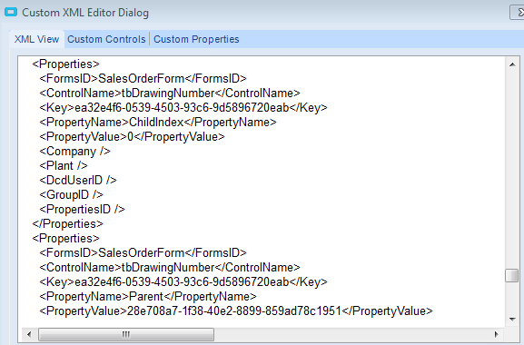

Have you tried exporting it, then editing the XML?
edit
Seems to work. I had to edit the GUID of the parent control in two places
and
But that moved it to the other group. Then I could place it where I wanted within that group
Hi Calvin,
Thanks for replying. No, I have not tried that. I know how to export the customization, but what would I be looking to edit in the XML? I can see this;
Which has the control and label contained about five times each. Is this where I do it? If so what do I need to change?

Done it. Thanks @ckrusen. Much easier than deleting them all and re creating .
