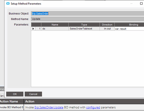

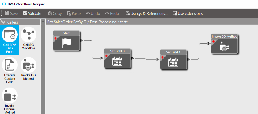

I created two custom fields: OrderHed.QuoteImported_c and OrderHed.QuoteImportedLines_c (both Boolean).
Then I went to SalesOrder.GetByID to do my BPM.
2
It does not work.
The value of the two custom fields remain false.
On the screen it changes the values from false to true, but if I refresh the view the fields turn false again.
I can’t understand why it does not work, it seems an easy BPM to me…
Can someone help me?
Thanks!
I’ve never had much luck with the Update methods. UpdateExt works for me, but it requires a different dataset type that you would need to populate instead of using the GetByID ds.
I can’t understand beacuse I have other GetByID methods that works with the Update Method invocation.
If I put the ‘Set Fields’ in one of them they don’t work (for the new fields).
It could have something to do with those UD fields technically not being on the OrderHed table, rather on the OrderHed_UD table.
I know method directives are generally preferred, but since there may be other logic changing these values - you could use a data-directive instead.
You probably can use the update method, you just need to mark the row as updated.
I didn’t a way to set this using a widget, so had to use a one liner in C# to do it:
JobDataSet.JobHead[0].RowMod = “U”;
If you’ve set the fields but they are being committed to the database, it’s probably because Epicor doesn’t know that they are changed (or dirty) rows. This single line will tell it so, and then normal processing will handle it. You do need to change the above to match your dataset.
When calling an update method, you have to set the rowmod to “U”. I think this is possible in the Update Table by Query, but a line of code is “easier”. Not sure why the SetField widget isn’t able to set that field…
