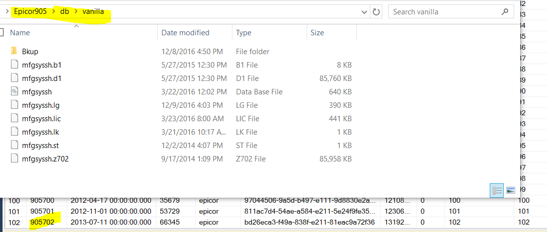

Is your SQL database a copy of production or a demo database or just the standard? I think this message refers to the progress schema being mismatched. If the database is not a copy of production just run this SQL and compare the two versions (production vs. vanilla). If they match I would assume the placeholders are the culprit.
It should just be the demo database that we got from Epicor as the Vanilla database. Could you provide the SQL query and what do you mean “placeholders”?
Compare this vs. a running version > select * from VntgPatchLevel

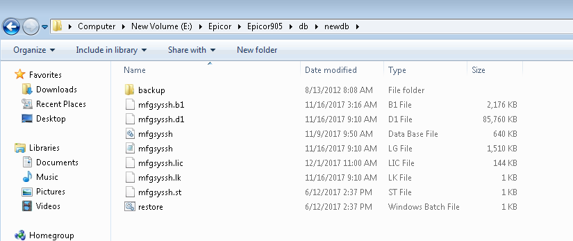

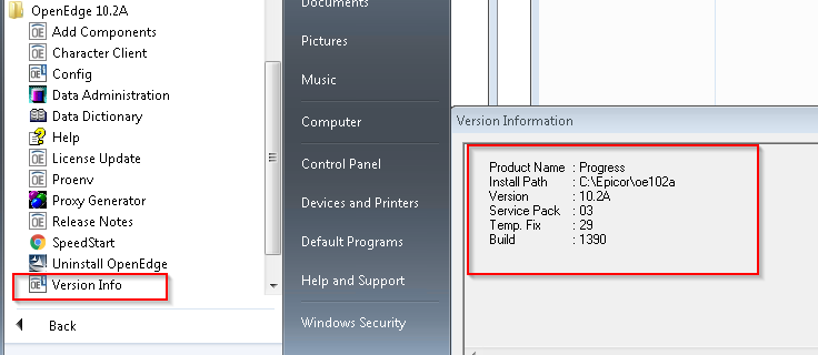

A couple things you can check. The first is comparing the OpenEdge Version to one running a current working application server (see screenshot). The second item would be to make sure these files did not get copied over to this folder and instead were properly restored to this folder. What process did you use for creating these?
The OpenEdge version is correct. We have other databases that are running on the same appserver and those get restarted ok.
