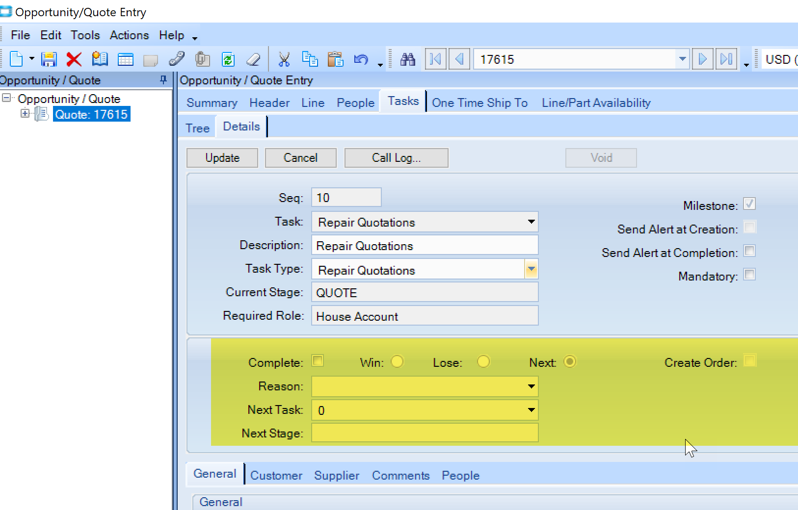

We do not use Tasks but needed to set them up in system back in E9 to get the quote entry to work. We have a single default task that gets assigned to everything, per below. Do you use tasks? Do you perhaps have something interesting clicked in the yellow highlighted area below? Want to take a screenshot of your task / detail tab and show what it looks like on quote and what your general task setup looks like?

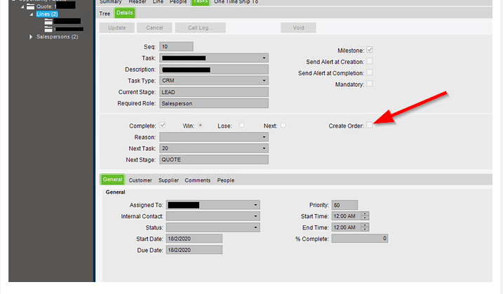

We don’t use Tasks either, but I see there is a box on your screenshot “Create Order”
Does that need to be checked? Or is that something that direct E10 to automatically create an order upon completeion?

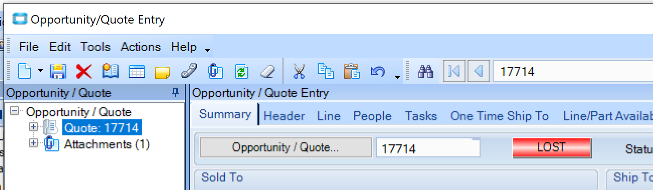

I have just had a user reporting that his quote is LOST and he cannot make a sales order from it. I asked if he recalled any processing that might’ve had impact. Nope.
Anyway, further hunting shows that if the user makes a sales order from the quote and then consequently deletes the associated sales order, the quote goes to LOST status automatically. I do not see anyway to get the quote status reset to allow more processing on it, short of making a copy and proceeding with new quote number.

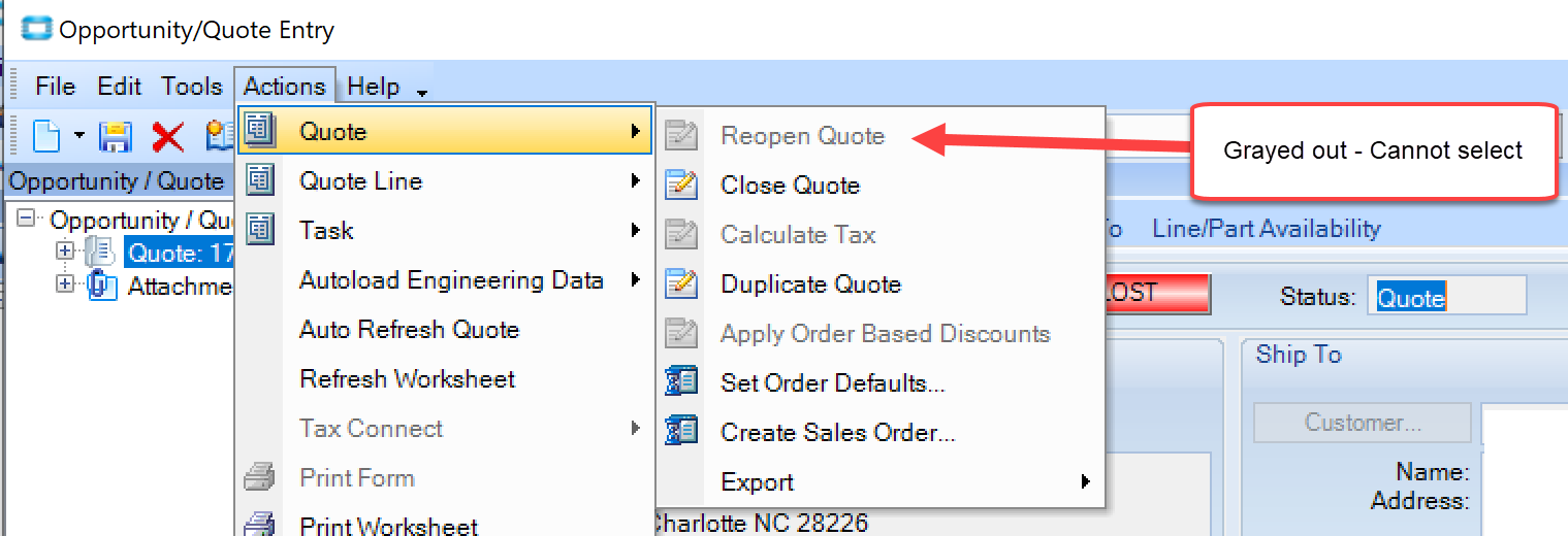

To un-lose (find?) a LOST quote, from Quote Entry choose Actions > Quote > Reopen Quote.
Hi Andrew,
Reopen quote is not an option for our LOST quotes…

I was afraid of that. There’s a lot of features with Quotes that I don’t completely understand how they interact. There’s Territories, Workforce Authorized Users, and Tasks (if you also have CRM) that can all come in to play. There is a setting in Company Configuration > Sales Module called “Prevent Changes” that might be important.
But, your screenshot shows Close Quote as available. That implies the quote is still open. In our quotes, any quote that shows as WON or LOST is always Complete, and that means it is Closed, I think. We have only 1 task in our Sales Task Set, and when we mark that task Complete, we have to choose either Win or Lose. Your setup must be different.
