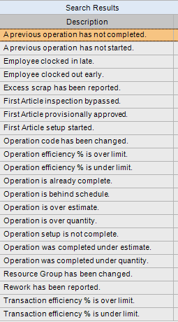

All of these things are achievable without custom code. I don’t think you even need BPMs (If your operators can be trusted to not flat out ignore a waring)
Shop warnings can display messages to MES operators for all of these scenarios and more, based on criteria you set up:
There is also a feature called ‘Production Yield Recalculation’ that will update the expected production yield on a job based on the quantity entered by an operator in MES.
Thank you. Yes we do have those warnings turned on and they should stop at completing an op if the prior hasn’t been completed. We’re just trying to “add guardrails” to keep the shop on track.

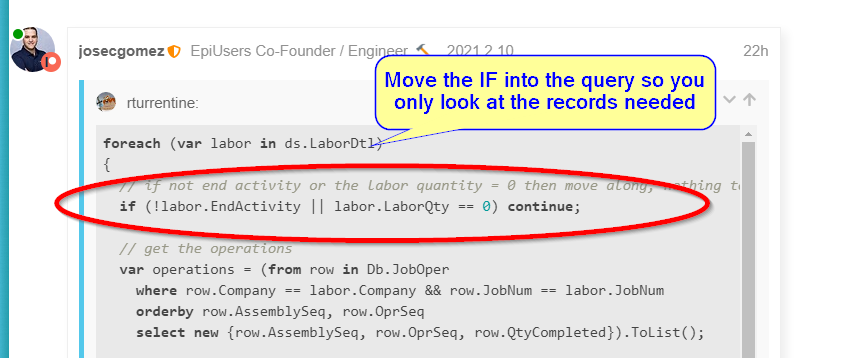

of course, there are always improvements that can be made to programs… I would enhance the initial query to include the IF condition so that you are not looping through a bunch of records that are going to get “continued”.
