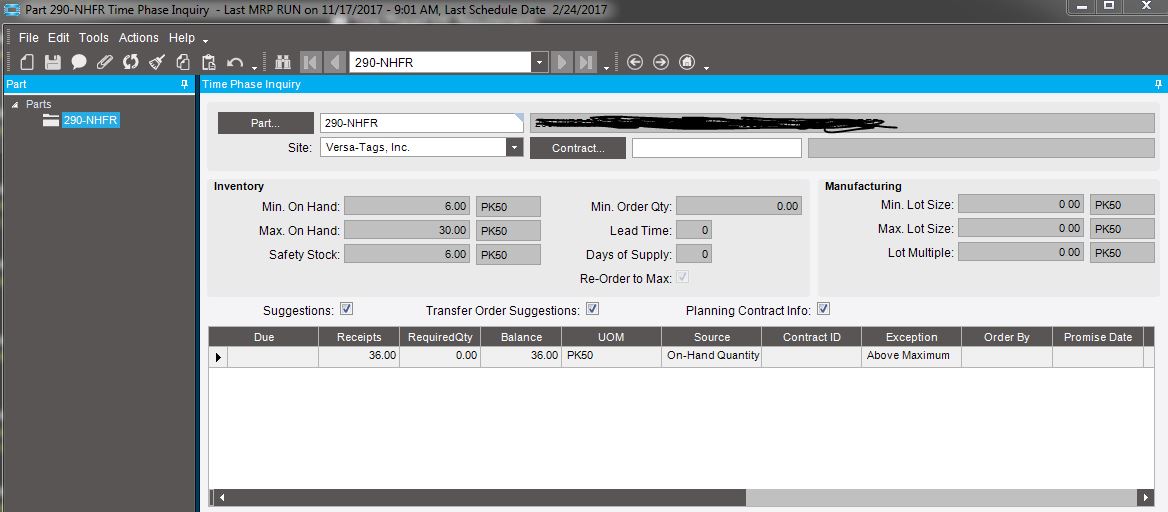

Have you looked at the Time Phase Inquiry for the part that should show you where the demand is coming from I think.
Yeah, here’s a screenshot of it.
johndack is right
  1. MRP will look into the future based on the date you run MRP to let’s say 2-28-2018
  2. Anywhere from NOW until 2-28-2018 when the qty-availability of a part is below min or projected to be zero… and
  3. there is DEMAND (need for that part)… then an un-firm job will be suggested (utilizing the lead-time to complete that part)
Your inventory will hit ZERO on 12-15 for a stocked-sub-asm or a stocked Fin-good
The lead time to manufacture is 10 manufacturing calendar days… you ONLY work (per your production calendar m-t-w-t-f
An unfirm JOB suggestion should POP-UP on 12-3 (or sooner, based on other setting) to build the part!
DEMAND can come from inventory replenishment; a sales-order; a sales forecast; or this sub-asm being needed on a different BOOKED-JOB.

Go look at TIME PHASE on this part…
You’ll see where the MIN would be violated with qty to go below 6.00
EPICOR wud back-out the lead time (in this screen it shows zero)
