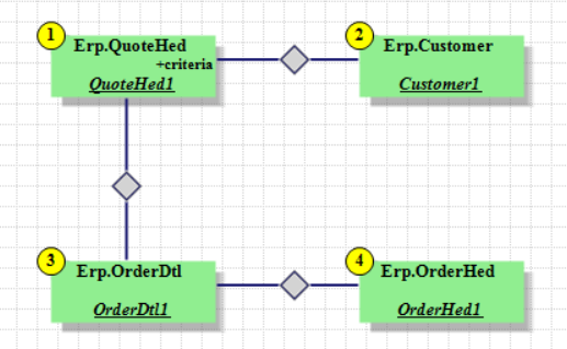

Can you put your query back like it was and show us a picture of your subquery list?
Hi Kevin,

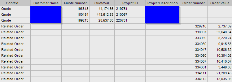

My original query was a Union one which had a Top Level identical to the one above, with sales order fields set to null. The Union was the same query with the quote fields set to null. It worked ok when only one quote was returned, it displayed the quote data with all attached orders below, but when I tried more than one quote it displayed all the quote lines then all the order details below. I am trying to list quote, then attached orders (eventually with a sum of the order values), then the next quote with all attached orders, and so on. I did play around with advanced grouping but to no avail.
It’s the nulls and your joins causing a problem.
No need for a union, the query above should work like you want with default link criteria if you change the
relationship between quotehed and orderdtl to a left join. (all rows from quotehed)

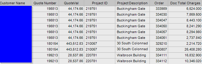

Hi Kevin, I tried what you suggested, but it’s still not looking how I want it to,
As you can see I have three quotes here. What I am trying to achieve is, line one showing the quote details, then on the lines below just the order numbers and values (not repeating the quote detail), then the next quote, followed by the order numbers and values, and so on.
yeah, what you are really looking for is a full outer join, you want to see all quotes with or with with out orders and you want to see any orders that do not have quotes. unfortunately, I have never been able to get the full outer join to work in a BAQ, so I think you were on the right track with the Union.

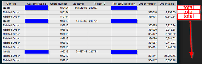

Ok, so I’m back on this today. I have reverted back to a Uninion query, which as you can see is returning three quotes, correctly, with all the related orders correctly, but they are not listed beneath the related quote as I want them. Like Quote, Related Orders, Quote, Related Orders, Quote, Related Orders.
Any ideas?

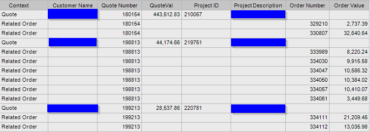

You should be able to put an order by on the top level. You just need a column to order it by. Do you have the quote number in all of the levels?
Thanks Brandon, I replaced the null on the quote number in the Union query with the quote number and then I get what I’m after.

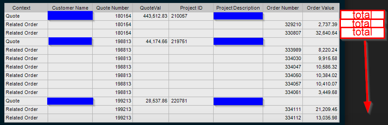

As a footnote, is it possible to sum the order value column for each quote, so we can quickly see the total value of orders against the quote?
