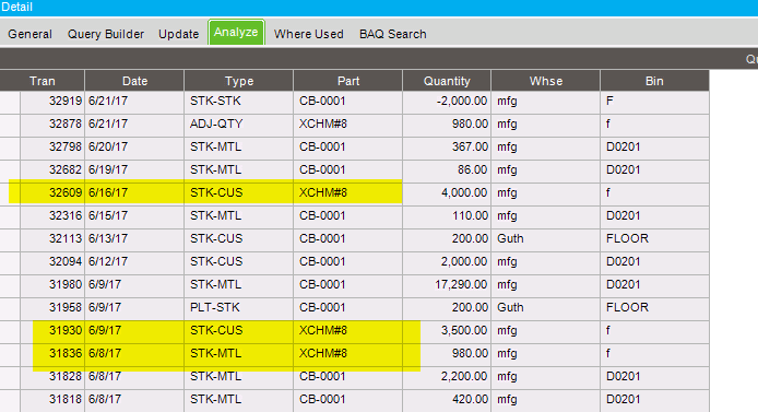

I got it working with 3 subqueries (counting the TopLevel one)
I needed to add parenthesis on the SubQueryList tab
I now get the desired output. I enter CB-0001 (CB-0001 is an Alternate for the now inactive XCHM#8)
Glad to hear it, good work!
