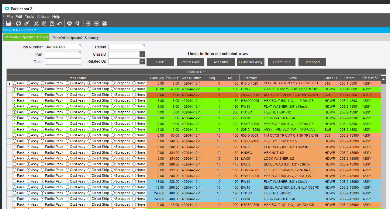

no, I have a dashboard where every assembly or material needs to have a pack status assigned to it. Someone is looking at a print and says “everything is assembled” so has mass selects and sets all of the parts to assembled. Or “everything packed loose” or "some is assembled and some packed, etc… They need to be able to quickly go through a list and set the appropriate status.

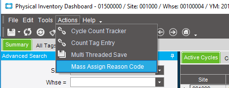

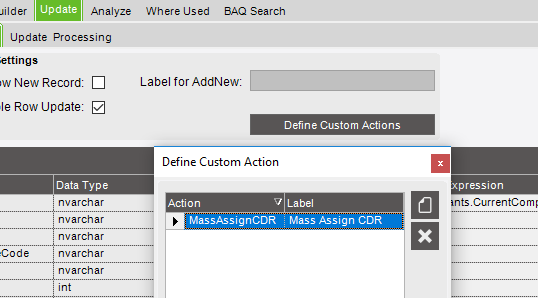

I was able to use a Custom Action with a BPM Form, then I did it via the Updatable BAQ BPM. In addition the Dashboard Published fields for visibility via bpmContext. May be a route to take.
CustomAction1

Maybe… Just remember you can add “BPMs” On Update, Custom Action etc on the BAQ itself and do basic LINQ to Update any table, especially custom columns.
2019-02-21_1805

It would fire then on your Dashboard and remain isolated within the UBAQ + Dashboard, for maintenance purposes.

So just an update for everyone, I solved this by creating 3 queries. One for adding new records, one for deleting records, and one for updating records. In the customization on the dashboard (shown previosly) I added a button to trigger the dynamic queries, and then looped through the results calling the adapter for UD08 to add, delete or update respectively. After some fiddling around with adapters I was able to get everything to work. I was worried about performance to be slow, but it’s surprisingly quick, probably thanks to the UD BO not really having any special rules to follow.
I probably (maybe should have??) done all of this on the server side with a BPM on my queries, but I’m a little more familiar with the client side, so that’s the way I went.
At the end of the day, the guy that’s doing the work can hit one button when he needs the tables updated, it takes about 5 to 10 seconds to run if there is a lot to update, and he’s ready to go. Much better than us manufacturing engineers copy pasting into DMT anymore.
