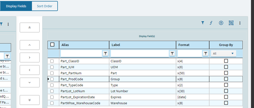

I’ve created a custom BAQ. I’m trying to run an Inventory report using 3 tables. Table 1 = PartLot, Table 2 = Part, Table 3 = PartBin.
I need the following fields returned: Class ID, IUM, PN, ProdCode, TypeCode, OnhandQty, LotNum, ExpirationDate, WarehouseCode.
My query results return duplicate records for PN (part number) field every time no matter how I change the JOINS. Is it because Part Number also = unique identifier??
The relationship between the tables is Company and PartNum.
It becomes a bit confusing to me when joining more than two tables.
I tried using select DISTINCT but that did not work., I even tried DISTINCT at the Table Criteria level. did not work either.
Here’s my Query Phrase & Results. Any help in how to run this correctly is GREATLY appreciated. Thank You!
