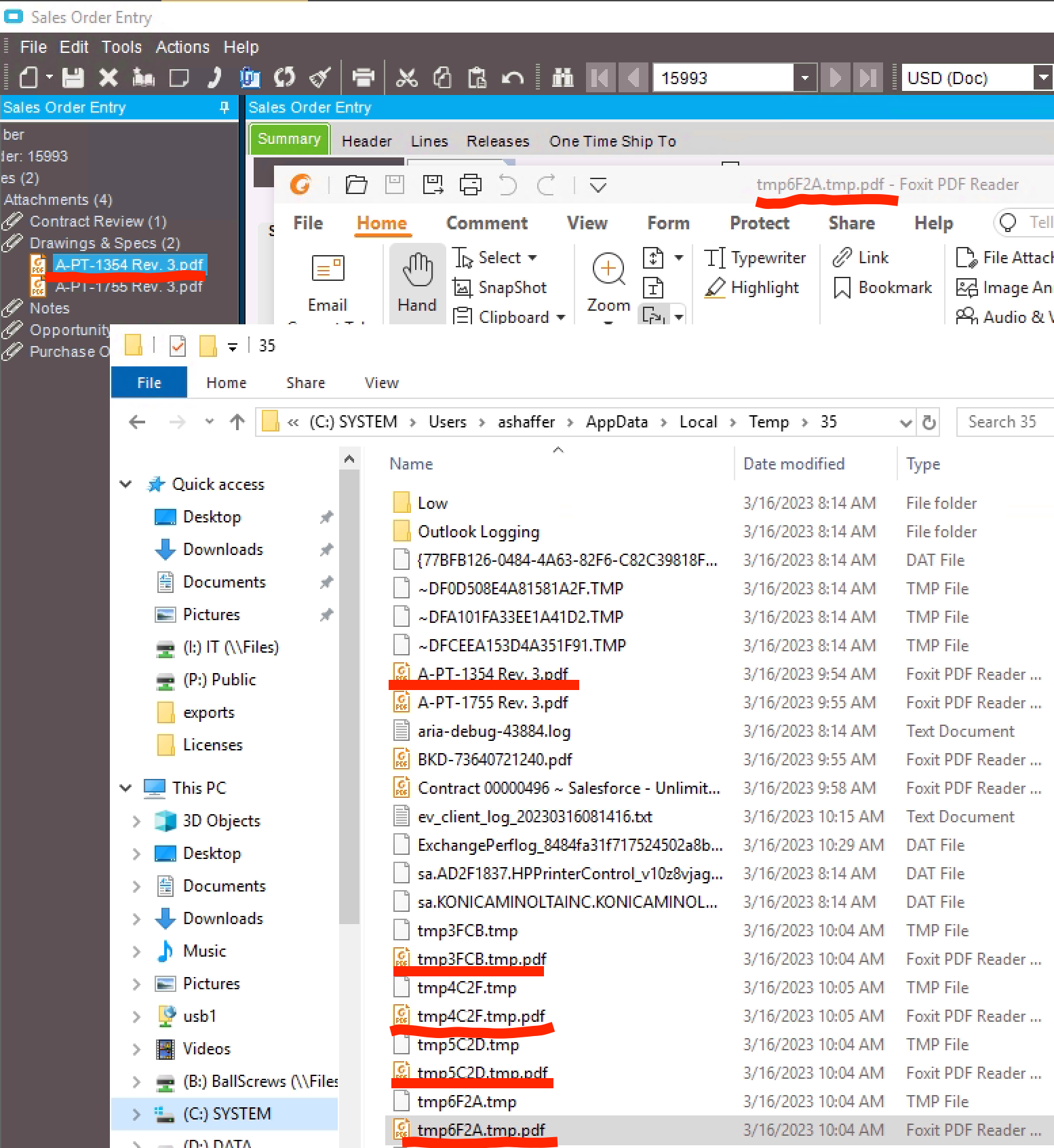

We attach .PDFs of part drawings to Sales Orders. Then when the order is processed by engineering, they have to open the Sales Order, open the PDF, save the PDF, then re-attach it to the matching Part Rev so that is there for all future jobs.
This mostly works but we are having issues with Epicor changing the file name, which is causing the engineers to have to manually re-name several PDFs before they can re-attach them. It is unnecessarily cumbersome and easy to make a mistake. Does anyone know how to make it PRESERVE the file name?
Just to rule out PDF reader issues, we tried several. The issue persists regardless of what the default PDF reader is. It is definitely an Epicor thing.
More specifically:
  1. you double-click on an attachment in Epicor
  2. it creates a copy in your TEMP folder with that same file name
    C:\Users\ashaffer\AppData\Local\Temp\35\A-PT-1354 Rev. 3.pdf
  3. you can save the file from the PDF reader and it will preserve the name
But the next time you open the same file, this happens instead:
  2. it detects a previous file with that file name (A-PT-1354 Rev. 3.pdf) already in your TEMP folder and so instead creates a 2nd file in your TEMP folder with the random TMP file names
    C:\Users\ashaffer\AppData\Local\Temp\35\tmp7659.tmp.pdf
  3. you can save the file from your reader and it will use the random TMP file name, and so requires manually re-naming the files.
I am open to any alternate process that might work. They are requesting a drag-and-drop ability but I see no way to do that. I don’t know if it is related but we are using DocStar as the attachment back-end. The end users never see DocStar, but the attachments are being stored in DocStar.
