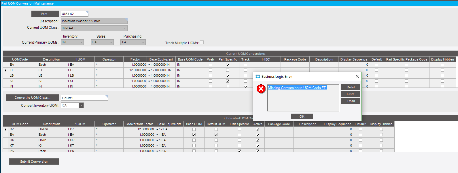

I have a part the was assigned the wrong part class, Length when it should have been Count. When I try to run the conversion I get an error saying, “Missing Conversion to UOM Code FT.” I’ve made a Quantity Adjustment to make sure there are none in stock.
Here is a screenshot of what I’m trying to do.
Any pointers?
Do you have “ft” define in your UOM table?
1st, if you have made any transaction on the part you want to change, this tool doesn’t work.
2nd if you haven’t made transactions, you need to change the UOM Class to an “Other” type whoich contains the UOMs you want PLUS a conversion factor from the BASE UOM in the Class you are switching from. in your case you need to add a FT to EA conversion to your New class…

To do a part UOM conversion from one class to another requires making an intermediate class of type OTHER. This intermediate class must have all the UOM conversions that the class you’re going from has.
After running the conversion from the old class to the intermediate class, remove all the UOM conversions that you can. Then add the UOM conversions that the desired class has, to the intermeditate class. Then run the conversion from the intermediate to the final.

Part ABC-123 was created as class COUNT, with IUM of EA (should have been LENGTH & FT)
An ADJ-CST was created, making a Part Tran with UOMS of EA
You would:
1 Make a UOM Class named “CNT-OTH”, of type OTHER
2. Add the conversions for UOMs: EA, DZ, BX20, FT, IN, and YD to class CNT-OTH. Set FT as the default
3. In Part Maint, make sure the PUM and SUM are the same as the IUM - for part ABC-123
3. Run the conversion for part ABC-123 From COUNT.EA To: CNT-OTH.FT
4. Remove UOM conversions EA, DZ and BX20 from class CNT-OTH
5. Run the conversion for part ABC-123 From CNT-OTH & FT To: LENGTH & FT
As mentioned above, some types of existing part transactions will prevent the process from working. And there’s no way around that.
