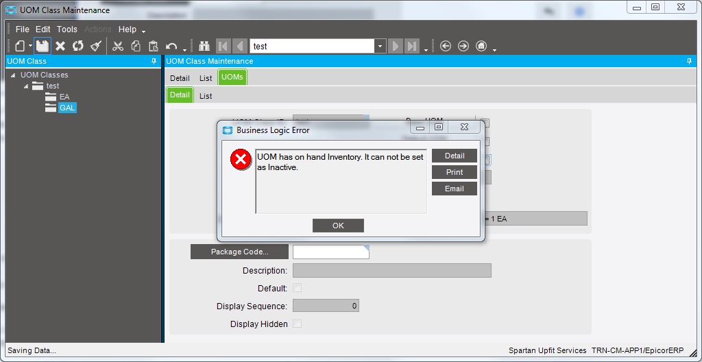

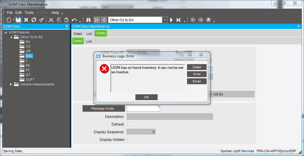

I created a new Class, added some UOMs and have only 1 EA Transaction, GAL’s is not USED Anywhere, why can’t I delete it… Is Epicor NOT Accounting for the ClassID and assumes that because I am using GAL’s via “Volume” I cant delete it from another Class which was made 5 min ago… ?
I just created this 10 seconds ago lol… .havent even used it, if you make a mistake you are screwed eh?
no wonder people use SQL

Same I just created a new one, just loaded that one - same Error… It’s Query is not accounting for the Class ID, just the UOM which I get because not everywhere is Class ID carried thru…
I would assume I am safe to use SQL and delete it:
Can you now delete the class “test”? Or does it balk because some of the conversions are “in use” - even though no part is of class “test”
It only accounts for UOM when doing its look-up, prob an Epicor Bug.
Yeah… Seems like it thinks you’re trying to delete the UOM, instead of removing it from the Class.

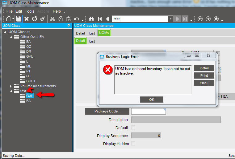

Weird, I can delete CUFT, I can delete ML, L – but not GAL and FT… from a test Class… We are on 10.1.500.31

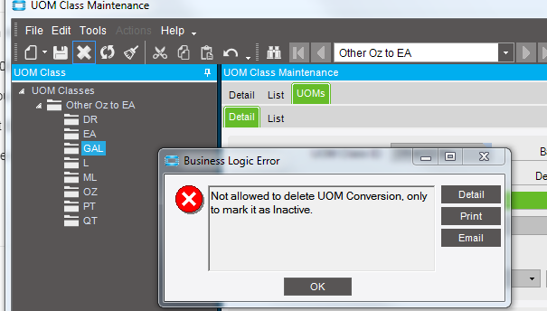

There is no Delete button unless you Inactivate it. So I blew it out via SQL for that Class.

I assume that you’ve never used that class (“Test”) you just made. so no parts or trans could have ever used it.
My guess is that Epicor added the requirement of making a conversion in active, before deleting it.

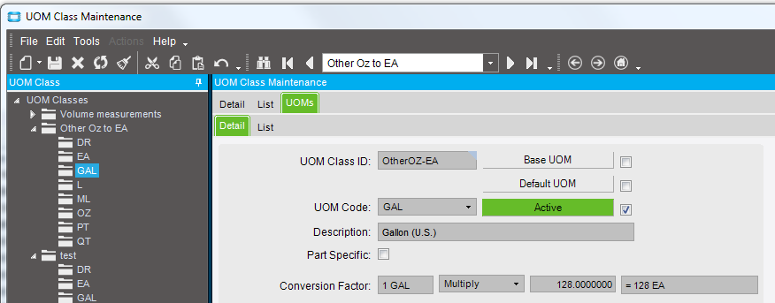

Whoa … If I select the UOM conversion in the list view, the delete button is enabled.
When I switch to the Details view the delete button is disabled:
I guess maybe I was wrong, it must be related to the On-Hand bug:
I can delete if its not in-use.
The thing is, I made a test class and added a UOM I know to be in use. And was then able to delete it from the class.
Have you ever done a Part UOM Conversion? I did that with this class, but the part had only 2 UOMs’ EA and OZ… Gallons no where… I had to put in all the Volume UOMs into my Target Class “Temporarily” for the Conversion to happen, once 2 Parts were converted, the idea was that I would go and Delete then those ones I don’t need on the Target UOM Class
I dont understand why GAL would be grayed out.

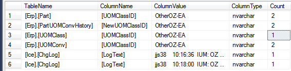

I even ran a Global SQL Search for that ClassID and Part to make sure I wasn’t deleting something which was being references somewhere… looks good to me:
I guess if your Class is used on 1 Part then the UOM’s on it are treated as “Does any record exist for the UOM, forget the Class, if so, gray out!” Because CUFT is enabled, i can change the multiplier etc… because its not used yet.

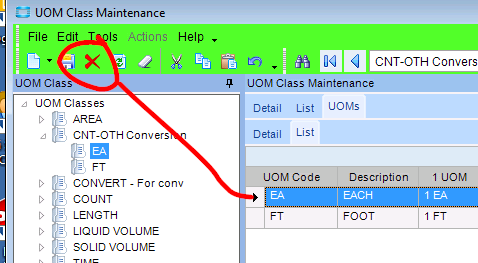

And looking at my system I know see I have the same exact problem as you.

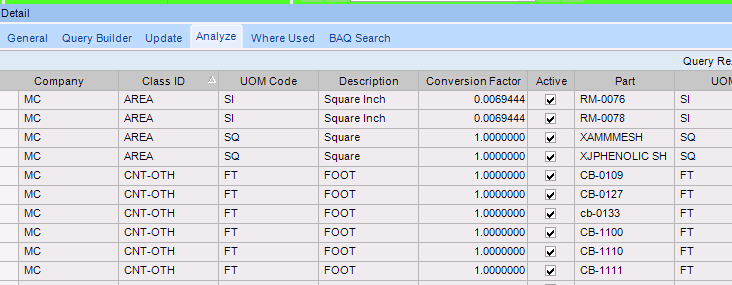

A bunch of parts were created as COUNT.EA, when they should have been LENGTH.FT.

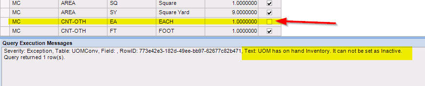

So I created a class CNT-OTH to make those parts be in FT. After doing the conversion, I now have no parts of CNT-OTH.EA
But cannot mark that conversion as inactive.
I wonder if a uBAQ could get around it. I was able to clear the Valid setting on Report Styles (in order to hide them) via a uBAQ. The program itself would allow you to clear it, but upon saving, it would just be set again.
Yesss!! Thats what I am after lol I deleted it now UDB
But here I am making sure I am not messing up some special “Referential Tables” and thus far doing a Global Search, It looks like just a Bug in the UOM Conversion Maintenance.
Just making sure I am not breaking some link and it used the “GAL” in some background tables, but thus far no sign of GAL
So with that I think it was safe to manually delete them.

Yup all it found was:

All those tables reference is EA to OZ.
