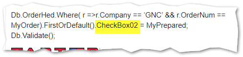

I am getting an error of “Too many characters in Character Literal”. The MyOrder and MyPrepared are variables I have set in the BPM prior to the custom code.
Below is the code I have
Db.OrderHed.Where( r =>r.Company == ‘GNC’ && r.OrderNum == MyOrder).FirstOrDefault().CheckBox02 = MyPrepared;
Db.Validate();
Whoops … 'GNC' should be "GNC"
I figured out the single quotes need to be double quotes but when running the BPM the record is not updating. Any suggestions.

Also … Trying to update Checkbox01 or 02 in the GNC company’s OrderHed?
While your code is:

Great eyes !!! That would make a difference. LOL
Got it working.
