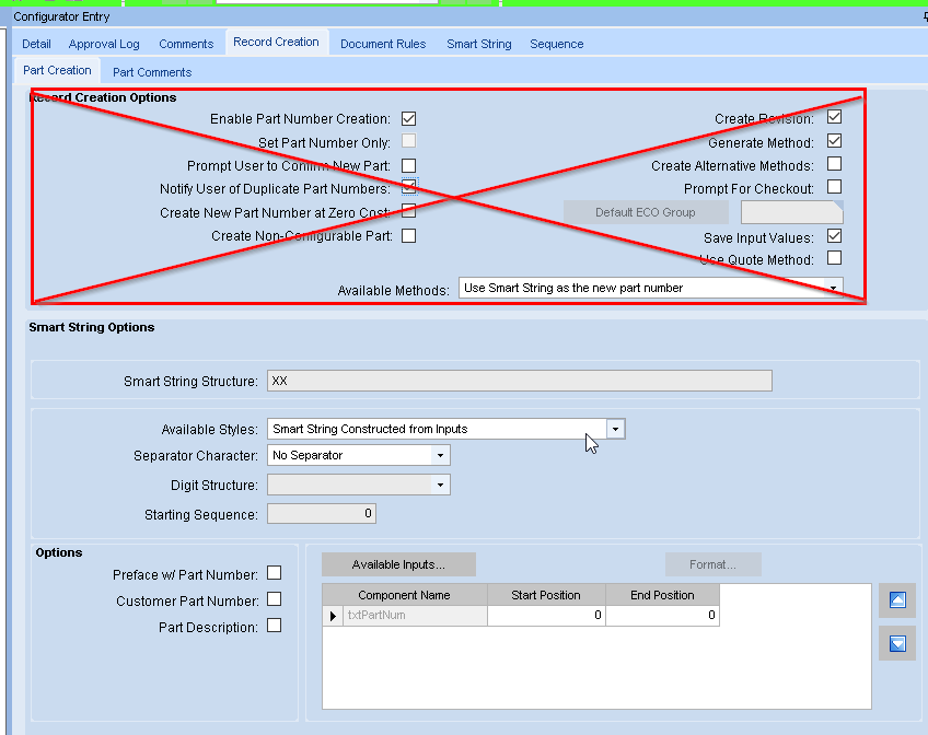

On the Record Creation tab of the Configurator Entry window, use the Smart String and Options sections:
With the above settings, the partnum will be set to whatever my configurator designer put into the text box txtPartNum.

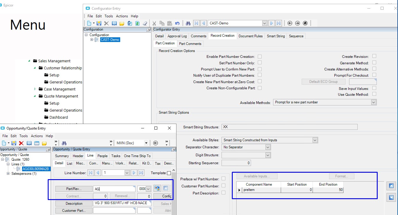

Hello,
I configure smart string, but it is not working. I wrote “Bottle” in my inputs preitem but when I saved configuration the value partnum did not change to Bottle. I attach a image, did you configure something wrong?
Thank you

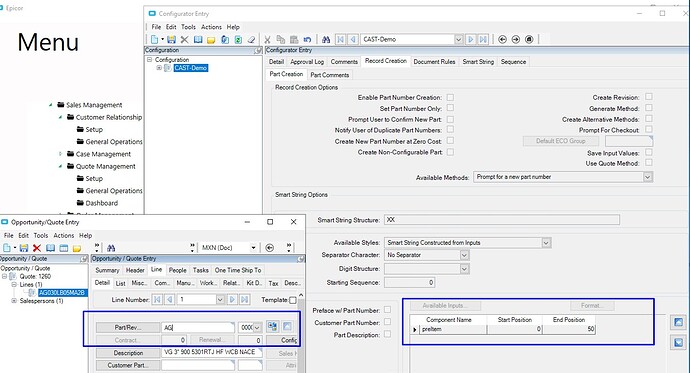

Try deleting the line and making a new one. Sometimes an already configured part (configured by a different configurator setup) won’t update the Partnum
Hello,
I created a new line and it is not working; the partnum didn’t update. Any idea? Thank you

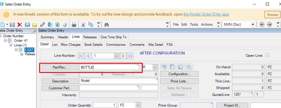

It is working, I add configurations that you mentioned previous quote and now it is working. Thank you so much :slight_smile: . A last question, is it possible the smart string happens in sales order and not happen in quote?
Thank you.
Yes. Unapprove the configurator, unselect the Quote Detail Allow Record Creation check box, then re-approve.
@ckrusen the configuration is working. I appreciate your time and answers. I have no more doubts. Thank you.Regards.
