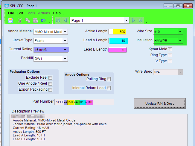

I’m having trouble understanding how to make a configurator to use a Smart String Input.
I know how to make as smart string based on the user selections on the designed page. But I want to allow a user to enter the Smart String as the input.
For example, in the following configurator input, the user enters/selects values in the upper part, and the Part Number (lower middle) and Part Desc are dynamically generated (upon clicking the “Update P/N & Desc” button.
What I’m trying to do is have the user enter a Smart String instead of making the individual selections. I.E. the user would just enter “SPLF-A0500-AH010-010” during order entry.

Agree that the word “Smart” is thrown around too much… Also, the incoming smart string is used for EDI to auto POPULATE fields… BUT one thing to be careful of is that this does not force any “on-field-changed” code in those fields to be run.
So… pretending that there is no such thing as a smart string input, here is how I have done what you described. I would suggest that you pass the smart string via the line item description on the sales order. ie, you would enter the configurator part number on the order, then enter the smartstring into the description. THEN you would configure it.
Inside the On-Page Loaded, you would add some code to examine the line description, and if found, split it out into all the other inputs (without the need for the button)

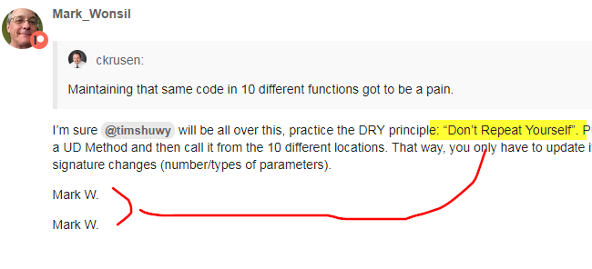

I’m sure @timshuwy will be all over this, practice the DRY principle: “Don’t Repeat Yourself”. Put that code in a UD Method and then call it from the 10 different locations. That way, you only have to update it if the signature changes (number/types of parameters).
