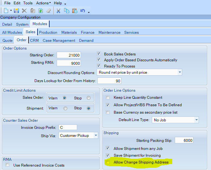

I do not use Epicor 10, I use 9 but this may help?
Company Maintenance > Company Configuration

I still need to test the setting in Company Config that was mentioned in a reply above. I hope to do that today.
