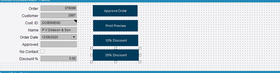

I have this dashboard with these buttons.
I would like ā€œApprove Orderā€ to update field ā€œOrderHed.Approve_cā€ with the text ā€œApprovedā€
and the others to update other fields e.g the discount field with the percentages.

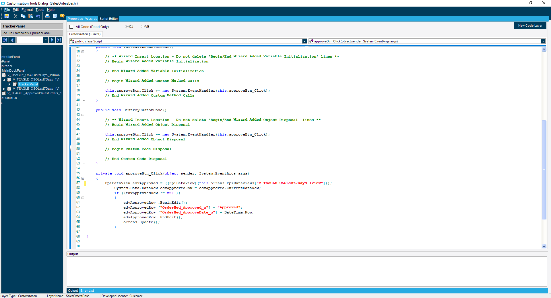

private void approveBtn_Click(object sender, System.EventArgs args)
	EpiDataView edvApproved = ((EpiDataView)(this.oTrans.EpiDataViews["V_TEAGLE-OSOLast7Days_1View"]));
		System.Data.DataRow edvApprovedRow = edvApproved.CurrentDataRow;
		if ((edvApprovedRow != null))
			edvApprovedRow .BeginEdit();
			edvApprovedRow ["OrderHed_Approved_c"] = "Approved";
			edvApprovedRow ["OrderHed_ApproveDate_c"] = DateTime.Now;
			edvApprovedRow .EndEdit();
			oTrans.Update();
I get it when I click the button.

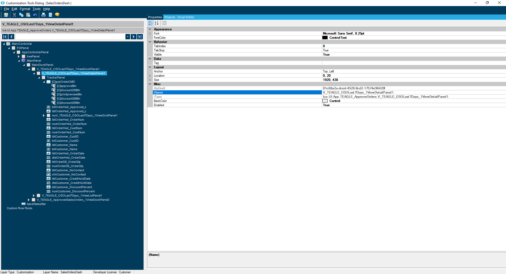

This is the what the object explorer is saying.
Kind regards,
Aaron.
Should your code have V_TEAGLE_OSOLast7Days_1View instead of V_TEAGLE-OSOLast7Days_1View? You can see for sure by the binding on the grid view.
Isn’t it based off your BAQs name?
The BAQs name is TEAGLE-OSOLast7Days

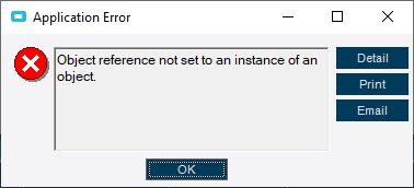

Hi Carson,
This didn’t resolve the issue. I’m getting this
