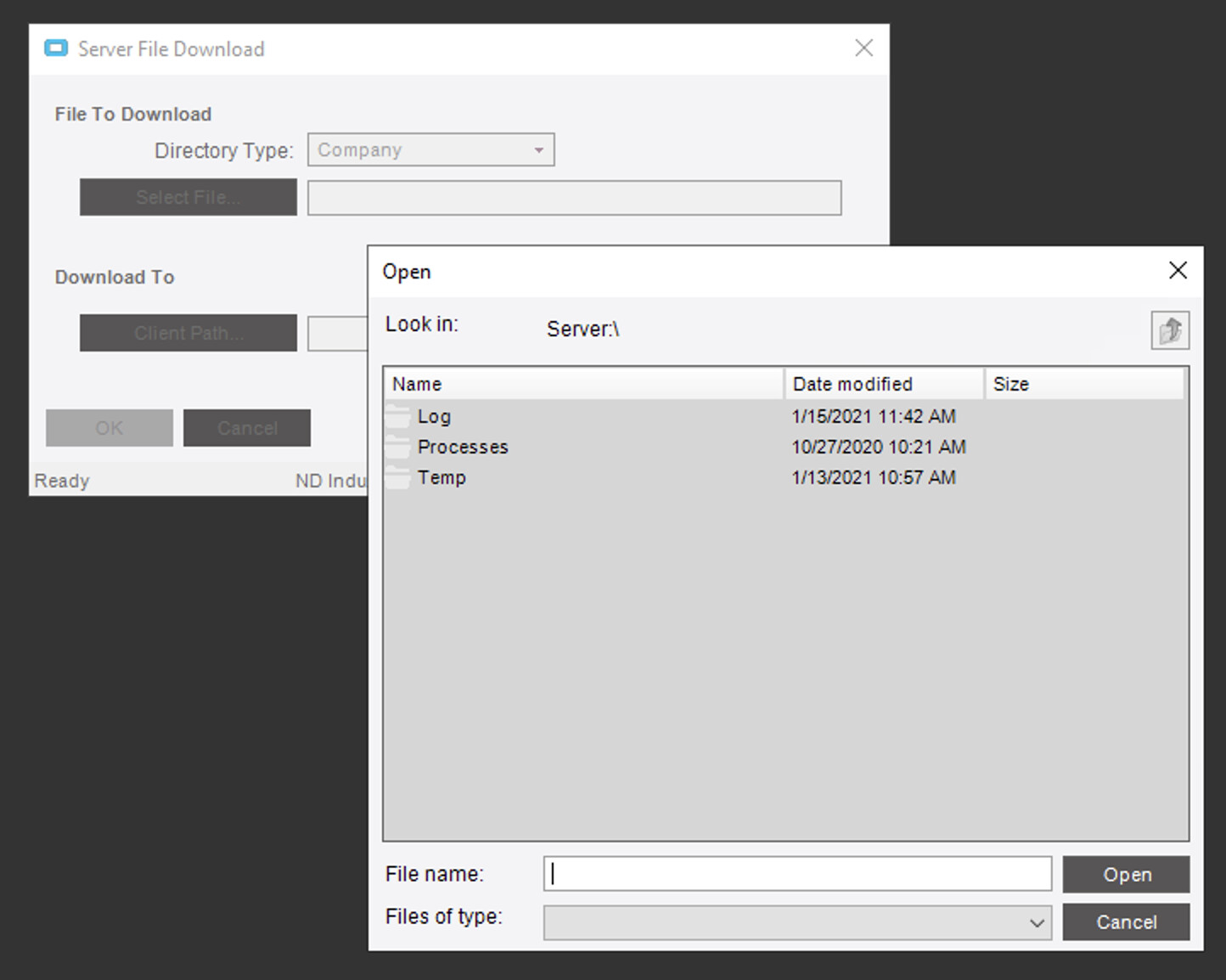

Thanks again for your help! Unfortunately I canāt check the server logs. I have to send a request to Epicor support to check them. Usually this is too much of a pain to bother with. I will keep playing with the BOs and see if I can get it going. I can tell a bunch have updated now. Thereās just something holding up the rest.

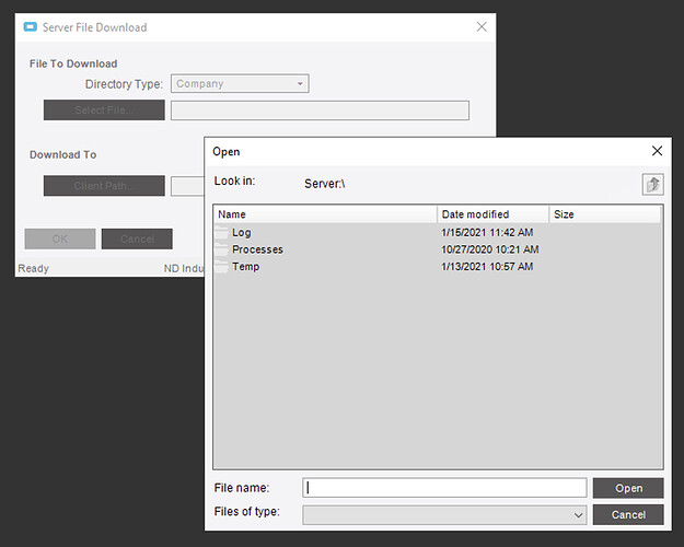

I was able to download one log, a āpelog.txtā. Its just a blank file. I will run a few more tests and check back here to see if I get anything in the logs. Do I have to turn on tracing or logging somewhere?
EDIT: I ran the custom action again with rowmod=u to generate the server side exception. This did not generate a log file, or update the existing log file. I tried again with tracing turned on. The trace didnāt show anything useful, and the log file is still blank.
