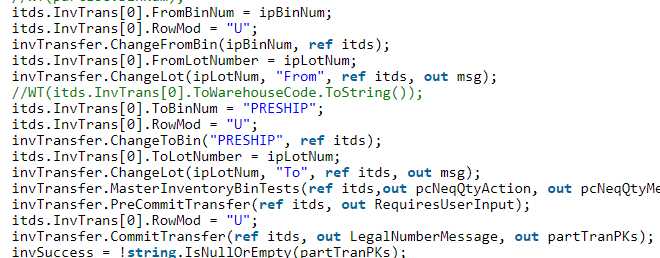

You might have to actually change the value on dsVend and then call ChangeVendPayMethod followed by setting RowMod = ā€œUā€ and then call Update.
Sometimes the ChangeXXX require the dataset to actually have the change.
I would do that with an Update by Query widget, right?
Example:
You see how the change is made in code to dataset and then the Change… method is called.
