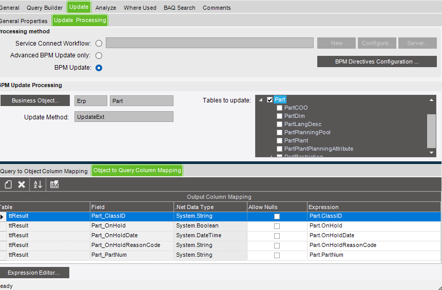

i have created updatable baq ,
what is the next step for generate automated emai notification??
please advice

@zeelthakkar21 if you want an email when any part hold is set do a data directive. if you only want an email from this baq then the code below is 90% of what you want.
if you put it post processing on update it will only see the updated rows. If hold is the only field they can change then you don’t even need conditions.
