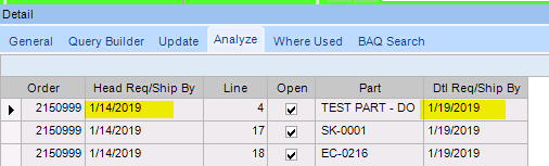

I just made a uBAQ to do some tests…
If the BAQ does not contain the OrderDtl table, updates to OrderHed.RequestDate do propagate through to OrderDtl and OrderRel (only if the Line or Release is open).
As soon as I added the OrderDtl table, the OrderDtl.RequestDate no longer updates. Not even for the one that includes the specific line.
Just after using “Get List” in BAQ Designer (i.e. original records)
(highlighting mine)
After editing the line, but before clicking "Update"
(changed OrderHed.ReqDAte from 1/14/19 to 1/23/19
After clicking "Update"
Notes:
  • The OdrerDtl.ReqDate did not change from the original setting of 1/19/19
  • The OrderHed.ReqDate for other rows of the same order do not reflect the change. hitting “Get List” causes a refresh and then all the other rows for this OrderNum now show the new OrderHed.ReqDate.
I can get the OrderDtl.ReqDate field to update (to match the value OrderHed.ReqDate was changed to) by setting the OrderDtl.ReqDate Expression as follows:
While that does cause the OrderDtl.ReqDate to update, only the LineNum that I changed (Line 4 in the prior images) is updated.
