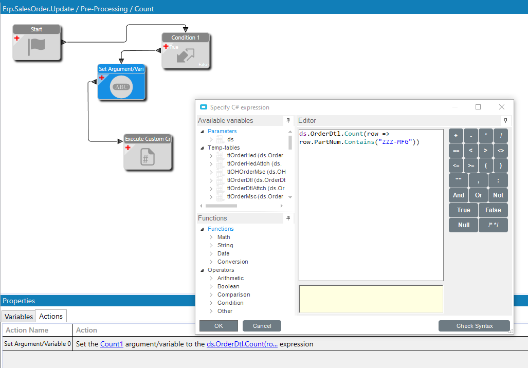

Created a BPM at SalesOrder.Update->PreProcessing
Condition:
Added argument/variable to keep count of number of lines
Used Custom Code to display value in Custom Orderhed field.

This way whenever a new line is added, system will look for custom part and adds a value in the Custom field at Orderhed.
I reversed the condition and custom code if line is deleted. This way it subtracts the values.
