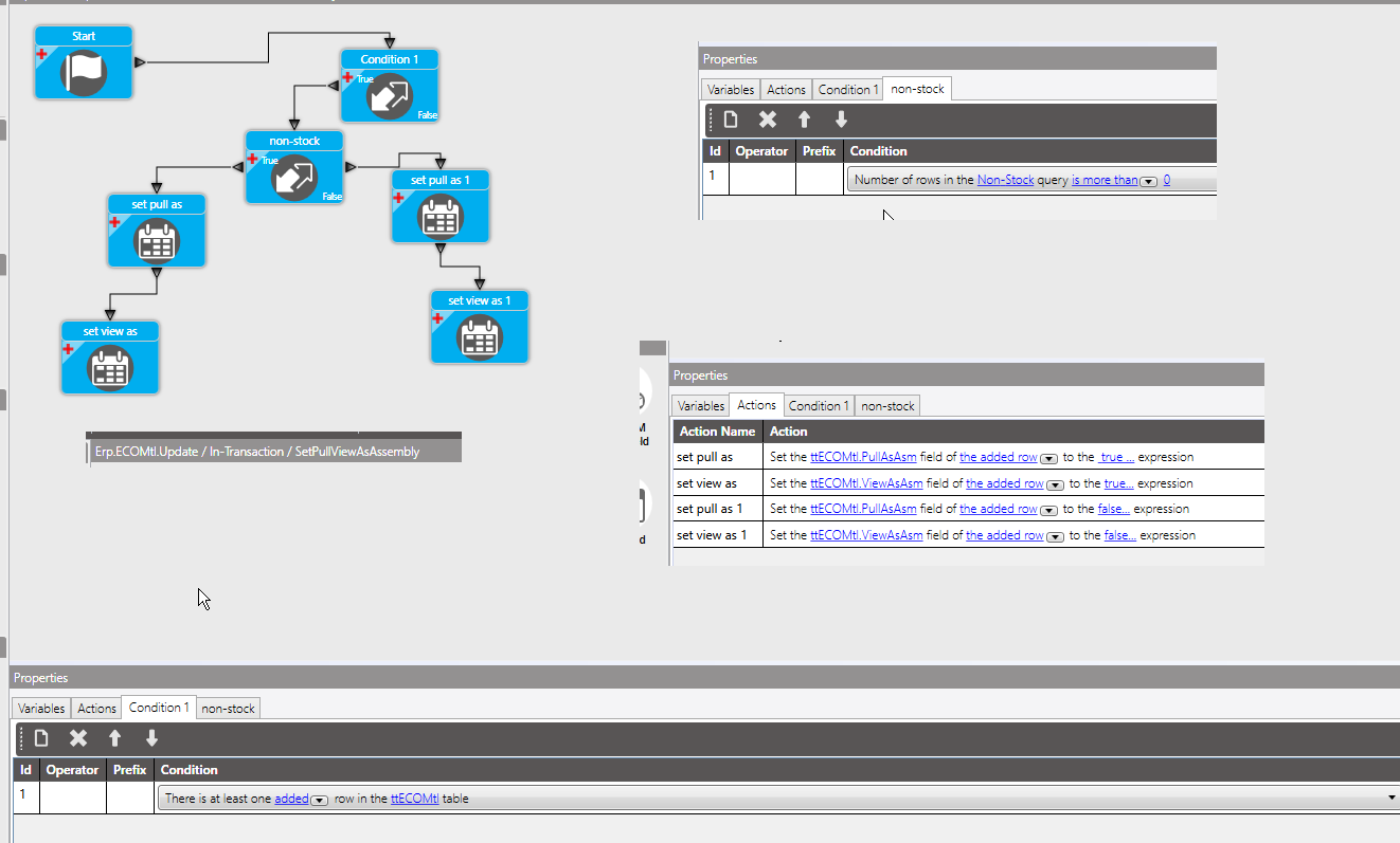

It has to be done in engineering workbench, so you have to check it out, make the change, then check it in. I use BPM’s on check out to set it based on our criteria, so we just check it out then back in right away.

It’s a data directive onthe ECOMtl table. Pretty simple really. Just a BPM Query to look at whether or not the part is stock or not (you would change this to look for whatever business rules you would have). Then just set the pull as assembly, and view as assembly fields. The solution is built with 10.2.200 so you should be able to uplift it to yours, although you should be able to build it with the screen shots pretty quickly.

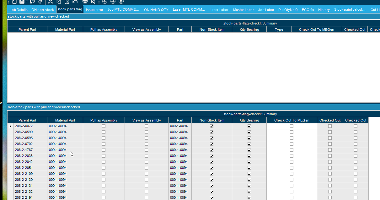

Yeah, Any time something is checked out, this will run. I have a dashboard the specifically looks for the condition that these would be mismatched, and have a check box to check it out. I just check the boxes to check it out, then go into engineering workbench and approve and check in all. You could probably automate it even farther if you wanted to.
i see you have a wonderful dashboard can you send that dashboard as well? I would like to see if this will be enough for what we want.
Here’s the BAQ for that part. The rest of the dashboard is stuff you won’t need. But the hard part is done in the BAQ.

There’s this too, if you have a list that you know you need.
