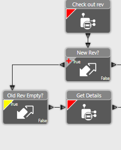

Yes, a BPM CAN be used to check a part out to the EWB, and even “Get details” from the old rev if necessary. This can be done all with Widgets. The “Check Out Rev” widget runs the EngWorkBench.CheckOut BO, and the Get Details widget runs the EngWrokBench.GetDetailsFromMethods BO… there before these 4 widgets run, there are a bunch of variable setters that run so that the two method widgets have data to run with.

if you add the widget, you can see what all the parameters are… but I believe that they are ECOGroup, Part#, Rev, AltMethod, plus a few other true/false values. The best way to see this is to go into Part Entry, turn on tracing, and then manually check a part out… Look at the trace, and you will see what all the parameters are that are “normally” used. (this is what I did the first time I used this widget).
@Banderson, i have made the same updatable dashboard where you can paste a list of part numbers, OLD revs, NEW revs, ECO Groups, and it will 1. create the new rev, 2. check out the part Rev, get details from the old rev into the new rev… the entire logic was done in Widgets. took about an hour to build and test.

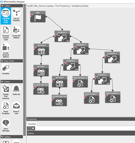

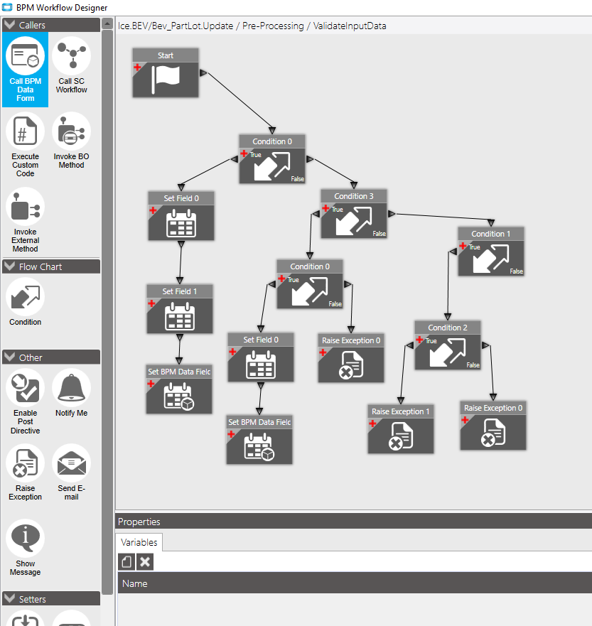

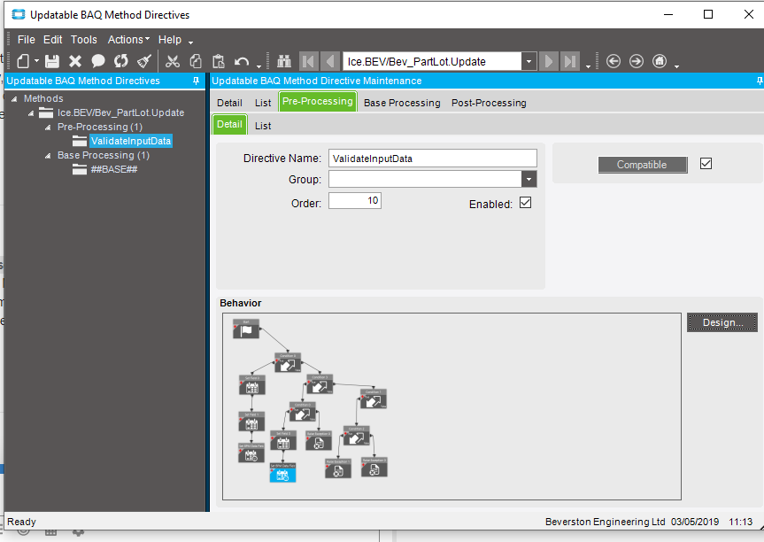

it depends on what you want to achieve if you want to do what @timshuwy saying then you need to use the ExtUpdate BPM of your uBAQ, and modify it accordingly, in this example i had to add a pre-process as well as altering the base one, others i had to disable the base completely and replace it by
a post process
