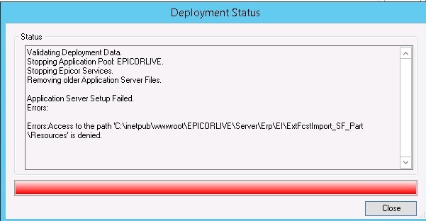

Had one strange error message. Page 19 Section 2.7 (upgrade Epicor Application Server) - Step 13.
Errors: Access to the path: C:\inetpub\wwwroot\EPICORLIVE\Server\Erp\EI\ExtFcstImport_SF_Part\Resources is denied.
I’m not sure what I did - but I went out and back into the admin console multiple times and in the process of documenting the error - it started working. I did not change anything (knowingly)
Other than that glitch - the installation went smoothly.

You could possible get that error because of permissions to write to that directory are not allowed.
Mr. Erik: Thank you for the suggestion. I was thinking along those lines also, except that the user I was logged in as has full privileges AND I did NOT change any security settings - but it all of a sudden worked.
HaHa - I guess doing the same thing over and over and expecting different results is . . .
It was file locking. I’m guessing this was an in place upgrade of the app server not a blow away and make new?
And this is what happens when you are in the middle of a test get distracted and close out of the admin console and come back forgetting to run as admin
