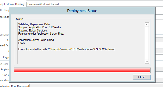

I was following the Upgrade documentation and successfully upgraded my Database in Database server management in the Admin cosole. I started upgrading the Appserver under Server Management and it failed. I can browse to the location but the file it is looking for does not exist. Not sure how to fix this…

The folder the web.config file is stored in is set to READ ONLY. I am a in the local admin group on the server and used my credentials to install everything. I have updated several revision with no problem. The Admin group shows full control.

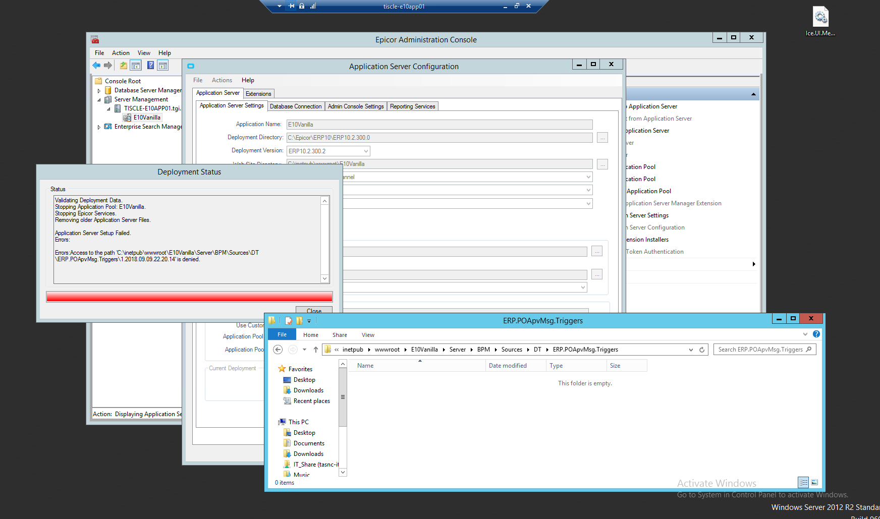

Thanks that worked but now a new error. I guess there are some things that should be disabled prior to upgradeing…I never saw that in documentation.
Here is the new error.

At first sight, I’d look and see whether the Epicor user (not you) has the necessary permissions, but it might simply be a problem that only Epicor themselves can sort out.
Try using a custom application pool account.
