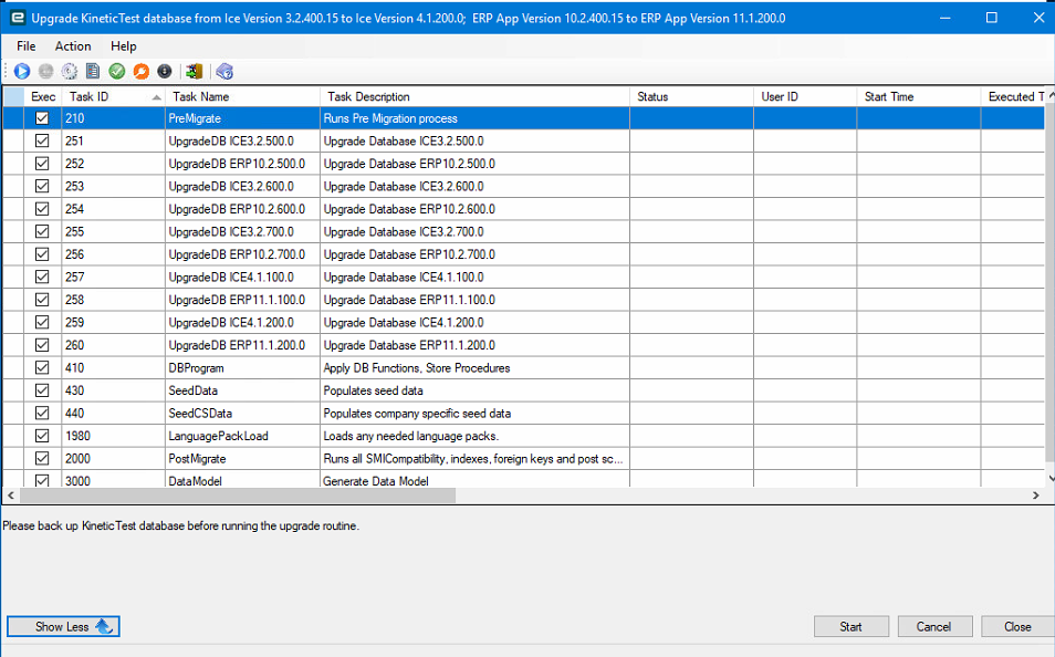

Upgrading the DB
Can’t seem to get it to perform the upgrade task.
Getting an error message you can share? What’s your SQL compatibility level?
@aarong I have in my notes that you may have to uncheck if they are all marked complete from a previous run. I am restoring a test db to run another conversion so I can do a screenshot, but it will be a while.
