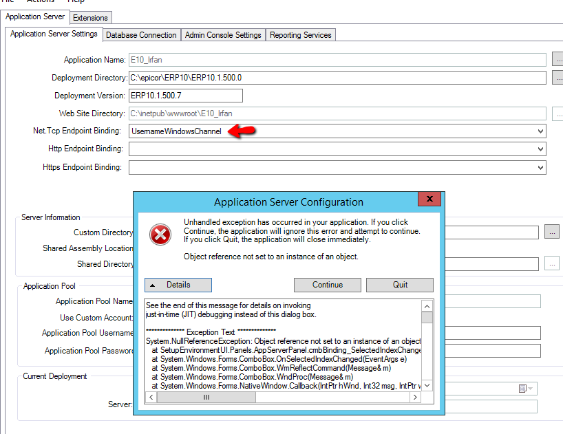

Anyone else getting an error when trying to Re-Register an AppServer after the step they tell you do Delete it and Re-Register… Cant pick the UsernameWindowsChannel without getting a Client Side / Admin Console Error with a Continue / Quit button.
But If i do not delete the App Server then I can update it as long as I skip the re-register step. Looks like a Admin Console bug.
Getting this exact problem right now trying to do a 10.1.400 to 10.2.200 upgrade.
Glad I remember I saw this post a while ago as I am running into the same thing and it is driving me crazy.
Did you ever get it resolved?
I had to go to the .config file which is an .xml where the Admin Console reads the Version number and decides which snapin to use and force it to 10.2 via xml.
