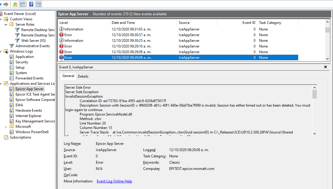

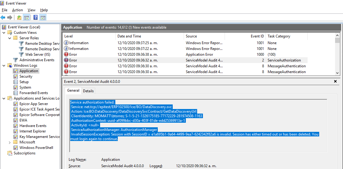

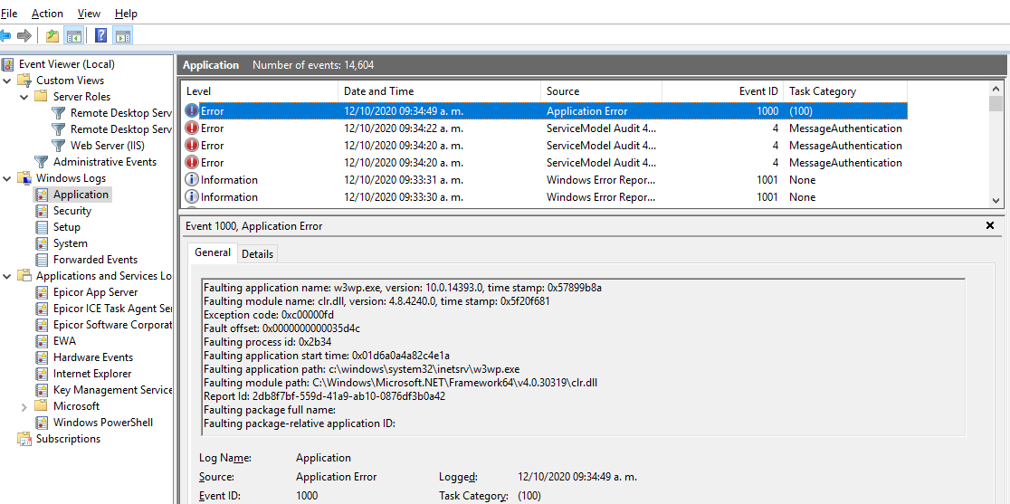

In the Epicor Server look at the Event Viewer and what do you see under
Applications Log
And App Server Log
By the looks of it, it seems the AppPool is not responding but you can get more from the Event Viewer on the server.
Thank you Jose, the logs…

The password was not changed, honestly I do not know what happens, I have hundreds of errors in the logs, yesterday I created a new virtual machine, I installed epicor from 0, but the errors of the previous server continue in the new one
