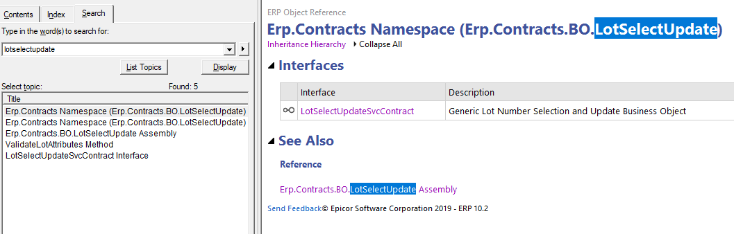

One thing that may be handy to figure this out would be the Business Object Reference documentation that you can find on Epicweb. Go to Products > Epicor ERP version 10 > Release: 10.2.400 > Deliverable: Technical Reference > ERP_BO_Ref_102400. This is a CHM file which provides reference to the Epicor business object assemblies. In the CHM file, go to the Search tab and search for “LotSelectUpdate”. If you open this file from a network drive, the right-hand pane may be blank. If so, copy it to a local drive and open it from there.

But I can’t find out the solution in this document. Seeking for your more advice. thanks.
