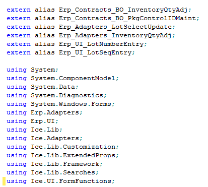

Specifically, I’m trying to use LotSelectUpdateDataSet and am getting the
“The type or namespace name ‘LotSelectUpdateDataSet’ could not be found”
message. I run into this occasionally, where there is no clear adapter to bring in to use this. I assumed it was part of LotSelectUpdate.dll but it is not resolving after adding it to the assembly. How do I go about finding out the adapter needed in the future?
I was under the assumption that it pulled them in automatically when you add the custom adapters? extern alias Erp_Adapters_LotSelectUpdate;
When I tried adding using Erp.Adapters.LotSelectUpdate; it gives a does not exist in Erp.Adapters message. Sorry for struggling with such a simple concept, I have such a hard time figuring out where all of these adapters and BO’s are coming from.
not sure you need the extern alias references, that’s usually a result of an uplift…
let’s back up a second. did you add the reference via the form wizard or manually?
If manually, it does look like you added both the reference to the Erp.Adapters.LotSelectUpdate and Erp.Contracts.BO.LotSelectUpdate assemblies, which is good.
If you remove the other references in the using statement, including the ones to the LotSelectUpdate ones, and comment out your code where it references, I assume it compiles?
Sometimes you need to save the form in a working state, reload it and then add in your references by uncommenting one thing at a time. I’ve had to do that before many times, especially after adding references
Okay, I did what you suggested and removed the references. (I’m using the Tools->Assembly Reference Manager). I commented out the lines of code using them, and it compiled. I saved, exited. Restarted and immediately loaded the customization. I added in the references and compiled, saved. Then I uncommented the first half (that was working before as well)
