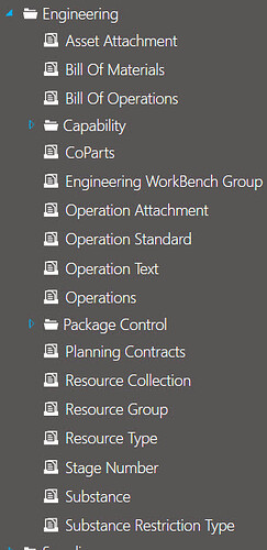

you would have to do this change as though it was a full engineering BOM change… use the ECOMtl template i believe.
Thanks Tim!! Is that a DMT Template?
yes
sorry… it is Bill Of Materials
Thanks! I’ll look at that
Hi Kelly,
I am not sure whether the highlighted column related operation below is required for DMT. I suspect these other columns are needed or useful for what you are doing with the DMT. You’d probably want to do a BAQ on the PartMtl table for approved revisions (tie in PartRev with criteria = true) and pull in these fields to make your DMT to change PullAsAsm to FALSE.
