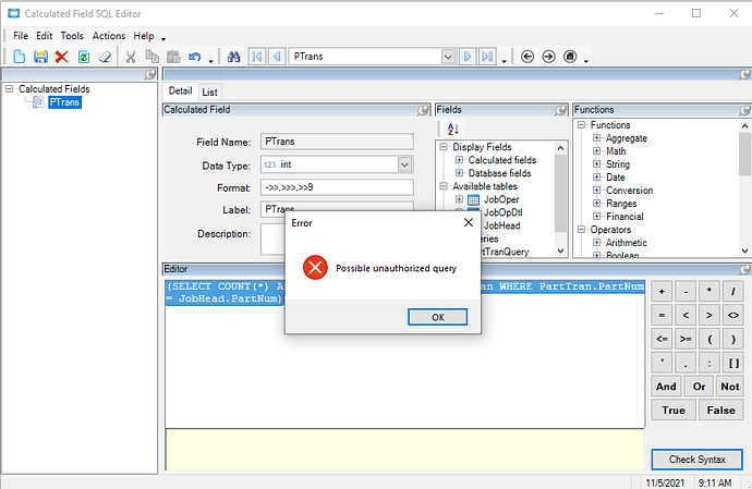

When I try to add that “SELECT COUNT” from PartTran as a Calculated Field, I get the error below:
Now I get that the error is being thrown due to a possible unauthorized query being present. What I don’t get, however, is a potential workaround.
