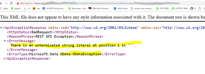

I’m moving on from an unsuccessful attempt to use AFR for extraction of a trial balance. Now I’m trying to make use of the Erp.BO REST api… I need to get GL period balances. Here is my call to Erp.BO.GLPeriodBalSearchSvc.
https://myserver/myinstance/api/v1/Erp.BO.GLPeriodBalSearchSvc/GLPeriodBalSearches(ABC,USDBOOK,1098|000,S,2019,,12,MAIN)
I believe it is finding the period balance ( because if I had entered any parameters incorrectly, I typically get a “record not found” message. )
But the data is not being retrieved successfully…
Does anyone know what that odataexception means in the image above? Is there a problem in the GL period balance results?

Quick Update… I had to specify strings with single quotes (helps to read the instructions in swagger).
