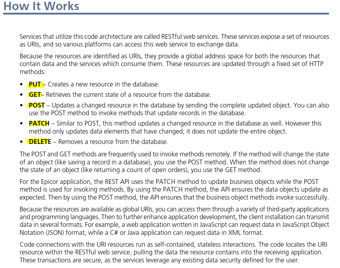

Do you understand the difference between the OData endpoints and the ‘legacy’ Custom Methods?
This can be kind of confusing as the OData ‘simplifications’ call back into the ‘custom’ methods. In other words there is a custom ‘GetByID’ method that is the same thing called by the adapters or over WCF. Then there is an OData method which treats the Entity (Customer) as the first class citizen instead of the method (GetByID).
If you ask for an explicit Customer over OData it would Customer(‘Some Identifying stuff’). That’s the OData query style.
If you want to retrieve a customer in the legacy way it would be CustomerSvc.GetByID(‘Parameters’)
The legacy methods are all done via POST - kind of the least common denominator.
The OData method uses the appropriate method based on the need of the Entity.
Get (for retrieve)
Post (For Upsert)
Delete (duh)
etc.
So first consider how you want to tackle the interaction.
Are simple queries and updates (Odata)enough? It’s an easier model if you don’t need the ‘Change this, Approve that’ kind of custom methods on the legacy API. We are trying to make the API more simple and flexible and hide the custom methods behind UpdateExt. All that goo in the client transaction.cs? Yea that should have been copied to UpdateExt intercepts on the server and are in the process of ensuring UpdateExt is as full featured as the client form. So expect you might run into a bug or two and have to fall back to custom. We’ll get there.
If you need the granularity of the custom methods, then all your querying will be via POST and the payload drives everything. This is very similar to what we do today when calling the server - Service.DoSomething(Blob of data). The blob is just in json for REST.

It looks like you have a mix in your query. You are specifying the payload and explicit method like you want to use the custom method GetByID. But the signatures you are trying to use are OData syntax with the select, etc on the query string.
Which do you want? :slight_smile:

Correct on odata allowing more custom data retrieval.
I used custom in the example only for apples to apples with wcf or impl based. We are seeing more use of odata on internal new products like mobilecrm, active home page, more to be announced.
