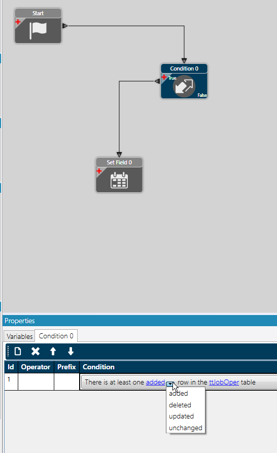

I have many BPMs that use the RowMod as a condition and I do not see them in the temp tables as a field.
Is there any way to do this without executing custom code? I am just trying to set a field value for new records.
This condition will be basically the same thing as a row mod.
Thank you. I didn’t see that as an option.
