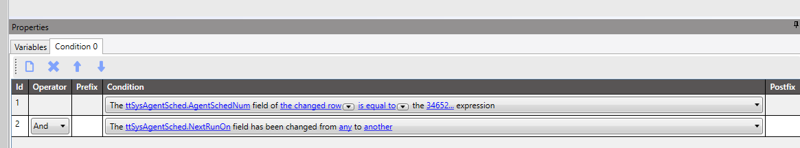

How would I set a condition, inside the BPM Workflow Designer, that states field must equal?

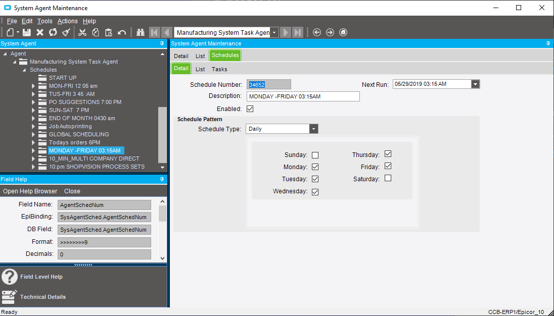

I want to set a condition that says the AgentSchedNum, in the SysAgentSched table, field must equal 34652.

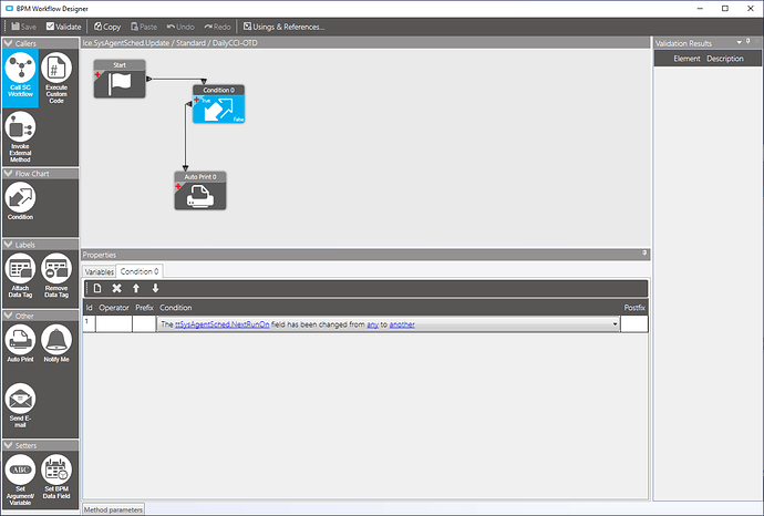

I would like to add another line to the second picture telling it only fire when then “NextRunOn” changes on the schedule in the first picture.

That’s exactly what I was looking for! Thank you! Worked perfect!
Trying to setup an auto-print function using data directives firing off a scheduling agent.
