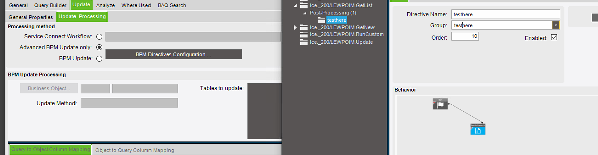

I have been looking for a way to run a schedule task to perform auto receiving form some data in CSV, there are a bunch of posted about using the GetList BPM that in the UBAQ’s and the REST api. But my issue is our current version does not have access to the GetList method with the REST api. We do however have access to the GetNew method of the UBAQ, does any one see any issue with using the GetNew method instead of the GetList to run a schedule task/process

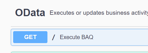

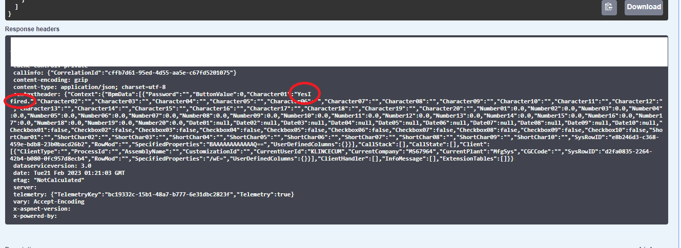

But the Get [/] Execute using rest in our current version does not fire the GetList BPM. I know we are on the first version to have REST and it’s only to show it off and its not support in this version 10.1.500 so that could be the issue. Which is what lead me to trying the the getnew method to see if it would work till we get on a newer version.

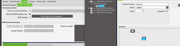

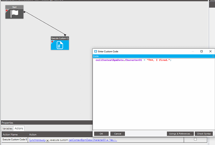

I did have set to send a email before for testing and if I get-list in the from the designers it would send the email but would not work from REST or when try to schedule a BAQ export in Epicor
The email is only sent when runing getlist from the designer. but I dont think I tested sending the email form the post-process yet on pre and base . So I will test post in the morning.
