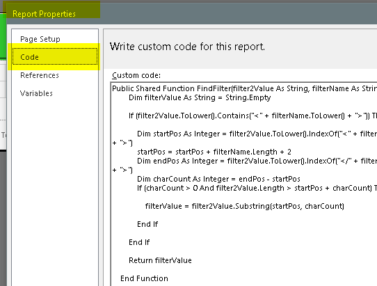

Is there a better way to edit the custom VB code in a SSRS report, than just selecting the Report properties, and going to the code sheet?
There’s no editor functionality (auto indent, block indent, find/replace, etc…), no syntax highlighting, no intellisense, etc… It doesn’t even have line numbers. So when there is an error, and the error includes the line number, you have to manually count. And the Properties dialog window always launches the same size. I have the expand the dialog window to make the editing area useful.
I’ve Started just entering code in Notepad2 (It has VB syntax highlighting and what not). Then copy and paste into the custom code field in MS Report Builder. But if I se one little thing that needs tweaking, I have to go back into Notepad2 and tweak it there, then copy and paste it back into Report builder. Else my two sets of code start to diverge.
