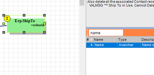

I am looking throughout the Customer table and can’t find a Ship To Name.

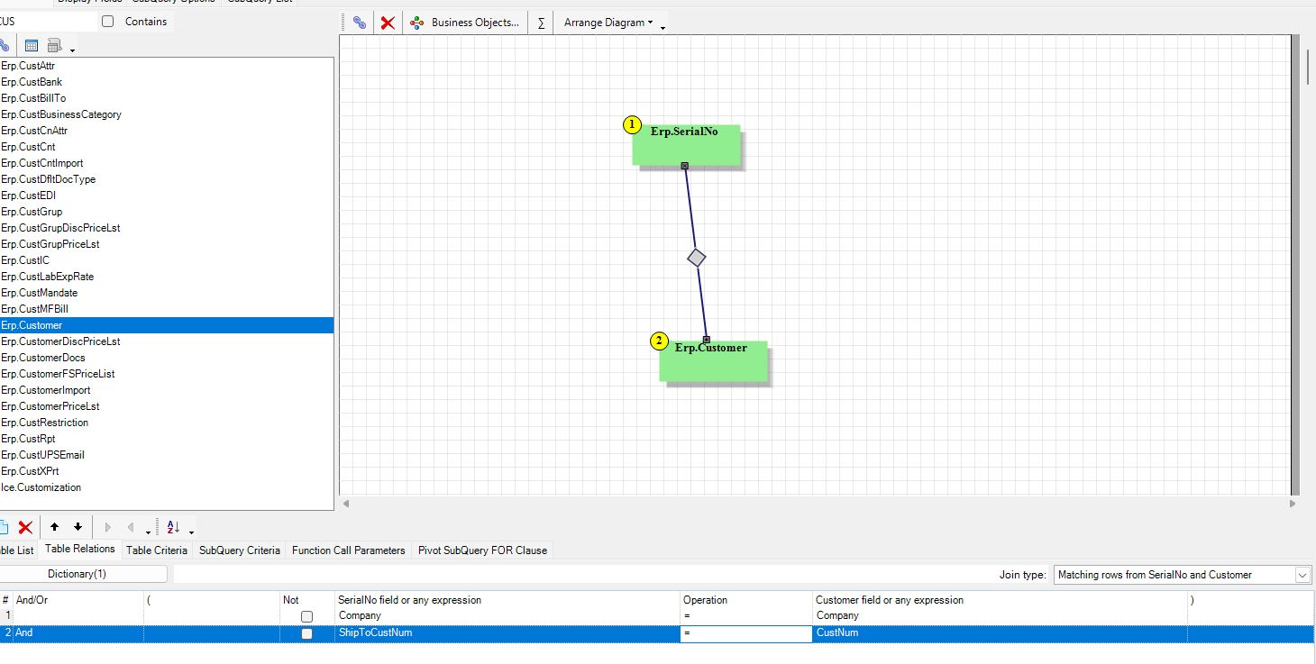

In the customer table you link to CustNum.
I have that set up, but going through the display columns in Customer I can’t find Ship To Name. There’s Customer Name and Ship To Number, just no Ship To Name. Unless I am missing something.
Thank you!
You will also need to connect the Erp.ShipTo table to get the Ship To Name

try linking it this way
I found the proper link to generate Ship To Name, thank you.

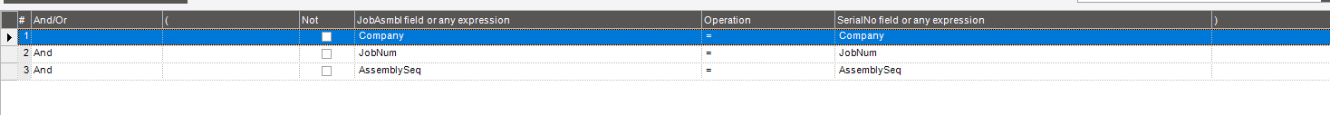

I disconnected the two and moved JobAsmbl to connect with SerialNo.

Link the JobAsmbl to the SerialNum Job fields.
