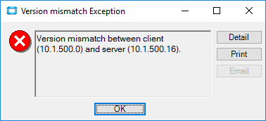

I tried making an update to the Live.sysconfig file and pushed it out to the users by updating it in the \isiepicor\ERP10.1.500.0Deployment directory. The clients start updating, but at the end I get the message saying there’s a version mismatch.
I looked at the config file that deployed and the version shows “10.1.500.16”.
In the end, I fixed it by running my deployment batch file which xcopies from the server to the client.
What went wrong? How come the update didn’t work?
The error occurred due to .dll files in the local client folder being the incorrect version.
That’s why you were able to fix it by updating from the server. If you just update the sysconfig file on the client it doesn’t really mean much. The client needs to grab ALL the new files from the server
But when the user opened the Epicor Client, it did the update routine and pulled the files from the server. It just didn’t work at the end.

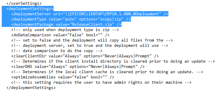

So to update all the clients wouldn’t you create the new ReleaseClient.zip on the Deployment server (matches the picture below from the config file) and then run the autoupdate program (or let Epicor run it for you)
So to wrap it up; you would take the updated (10.1.500.16) files and create the new ReleaseClient.zip file in the deployment server url and then run the AutoUpdate program. Then the autoupdate runs and if the config settings are correct, then it will grab the updated Releaseclient.zip file and extract the files to the users C:\Epicor\ERP10.1Client\Client folder.

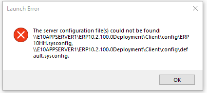

Sorry I am trying to follow the logic here and follow the correct procedure, but it just doesn’t seem to be working. I am trying to create a custom config file and I have the client already installed on my computer. I need to set a custom MES menu and change the login username to last instead of windows.
  1. In my local client config directory I copied the config file, renamed it and made my changes.
  2. I changed the shortcut on my desktop to point to the new config file (name only, not a full path).
    The problem - when I launch Epicor it says the file is missing from my server deployment directory.
    To solve the issue
  3. I moved (not copied) the config files from my local client config directory to the server deployment client config directory.
    The problem - when I launch Epicor again, it says the config files are missing from my local client config directory???
-When placing a new config file in the server deployment directory, is there some service/process that happens to put it into the releaseclient.zip?
-When does the auto update kick off to actually copy the config file from the server deployment directory to the local directory? Is there a time frame I should wait and expect the client to update?
-What config file is the clients actually pointing to at launch, the server or local?
-Do I need to copy the config file to both the server and client to make an update?
For the autoupdate on the client to work, there has to be a sysconfig file with the same name as on the client on the server. Instead of your step 3, copy the sysconfig file from the client to the server.
