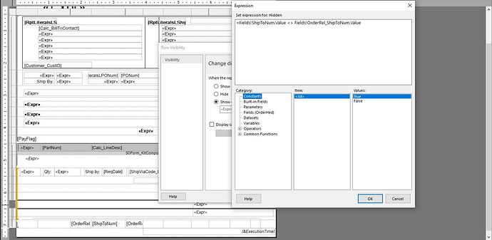

In a report, I need a field hid if ordered.shiptonum is equal to OrderRel.ShioToNum. I hit a wall, my head hurts :pensive:, decided to ask for help.
Can you walk us through what you have tried? perhaps with a few screenshots? Hidden logic should be a right click away
I am trying to do:
Fields!ShipToNum.Value <> Fields!OrderRel_ShipToNum.Value
So, when they are not the same, it shows. However, after looking into this, the OrderRel_ShipToNum isn’t pulling into the report. I have the Data Definition set up on it, and it is in the query.
Can you put both of those fields on the details section to see the values? You say the OrderRel_ShipToNum isn’t pulling into the report, so it sounds like the comparison should fail every time.

I figured out what I did wrong on getting the info to pull in. I had to put T3.ShipToNum AS OrderRel_ShipToNum. That did the trick for my end.
Now, IIF statements for visibility, I am thinking something like IIF ShipToNum’s are equal, then show, otherwise, hide. How would I put that in? This area I am a bit fuzzy on.
Use this
IIF(1=1, FALSE, TRUE)
