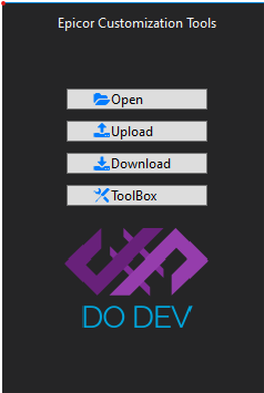

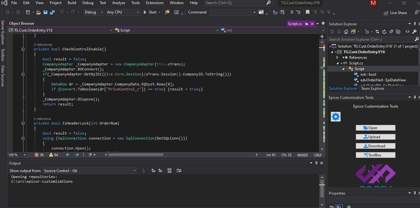

Thank you for creating this extension, looks fabulous.
I am having some issues with uploading code for seemingly random customizations. After some digging I think it has to do with the Newtonsoft.Json.JsonConvert.DeserializeObject
calls located in EpicorTWControl.xaml.cs when it’s parsing the CustomizationInfo.json file. In my particular case the Version field is a value of 6479548074, and the VSExtension.CustomizationClass.Version field is an Int32.
Attaching the debugger shows the following:
Exception thrown: 'Newtonsoft.Json.JsonReaderException' in Newtonsoft.Json.dll
An unhandled exception of type 'Newtonsoft.Json.JsonReaderException' occurred in Newtonsoft.Json.dll
JSON integer 6479548074 is too large or small for an Int32. Path 'Version', line 1, position 934.
