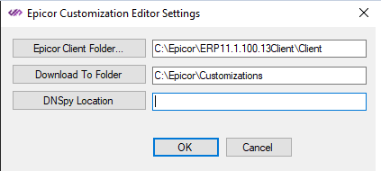

I had it pointing to the folder above Client, not the Client folder. But, this is how I got there.
I opened up VS and clicked Open. It said I needed to add settings. I added the settings correctly, but it still didn’t work. Then I thought that maybe the Customization Helper files were gone. So I redownloaded them and they were gone as I got no overwrite prompt when I unzipped. Then I had to redo the settings again and selected the wrong one.

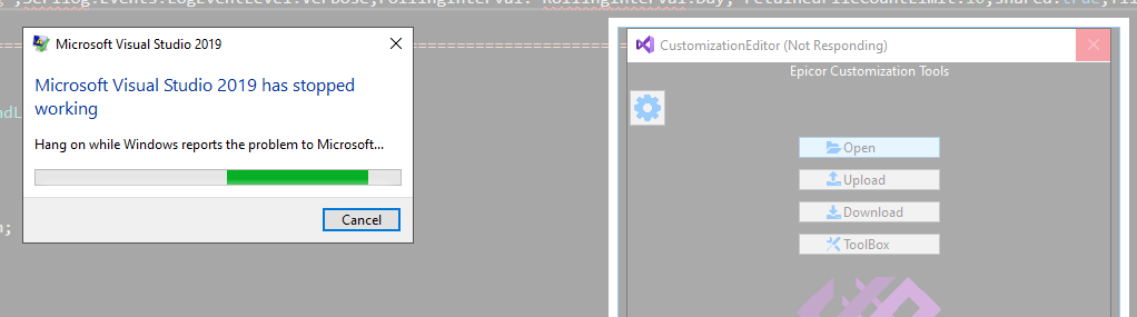

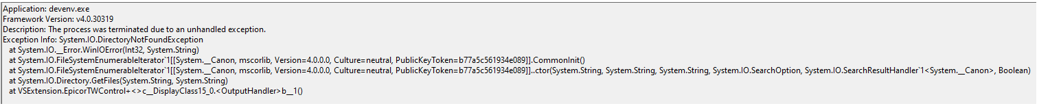

Has anyone with the crash on Open issue found a resolution?
I’m on version 11.1.100.13. using the 2021.1.x helper library. I made sure to unblock the archive before extracting to my client directory.
Settings:
Event Log:
When does the crash happen? Anything in the logs
When clicking on the Open button in the CustomizationEditor window.

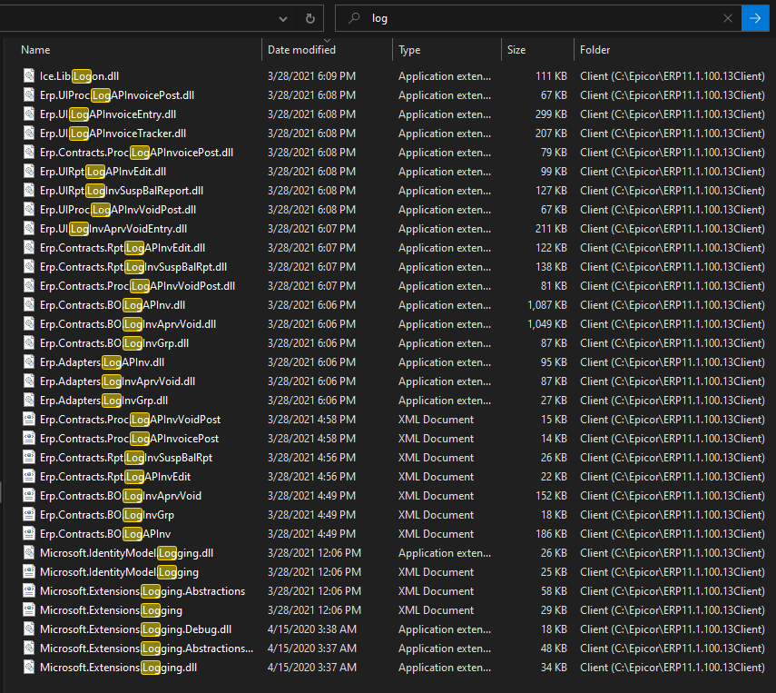

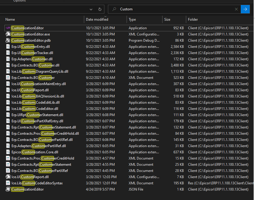

I looked in the client folder for a CustomizationEditor.log file, but nothing is showing up.
