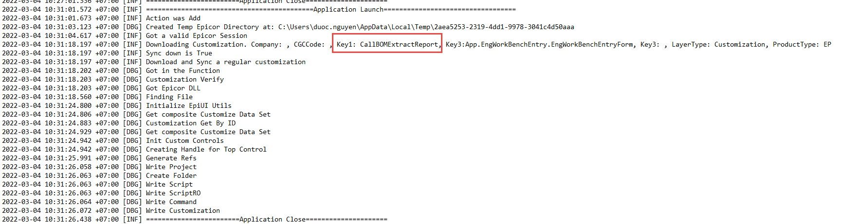

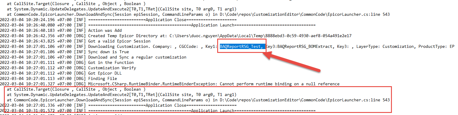

I got a strange issue, When i load my customizaition (BAQReportRSG_Test), Epicor tool can not load.
But when i load another customization (CallBOMExtractReport), it ok.

Can you open other customizations?
Thereâs a log in the Epicor Client Directory what does it say?
no, other customizations cause the crash too.
Fix was the download folder for the customizations needs to have more than read only permissions.

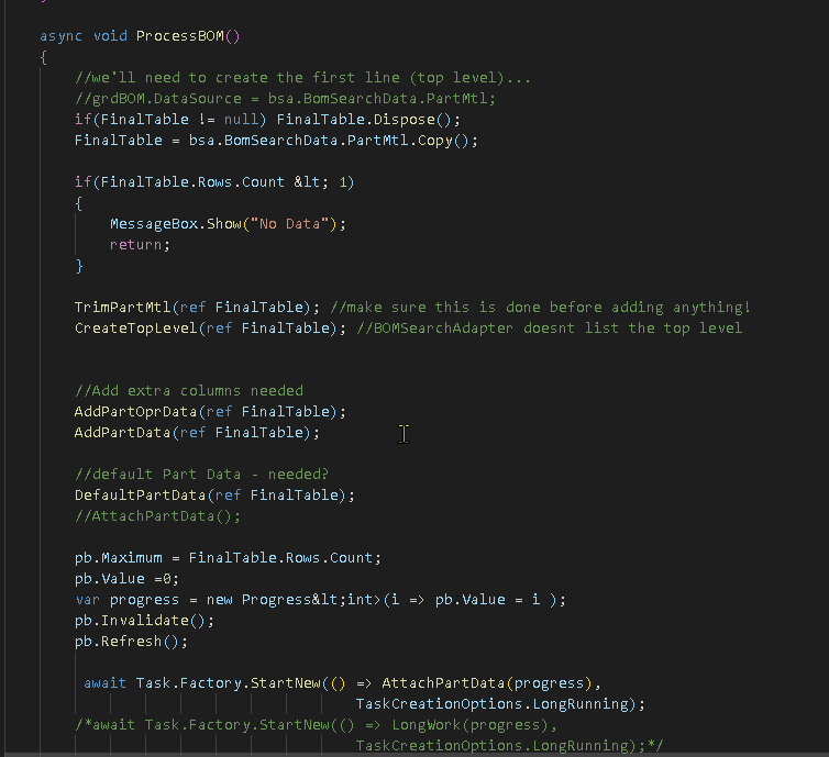

The original request to @Chris_Conn was to get a multi-level bom picking the part and rev and then using the latest revs for all the child parts (to mirror what MRP will do) and list out all the parts and their level on that top Part / Rev. after that it return part master info
What Im trying to do is understand how he got the full indented BOM so i can get a Max LeadTime of the full structure so we can put a ship by date on the sales order. So of all the parts it takes to make this Top level part , the max lead time of the purchased parts is X , then my ship by date should be (Today + X). id like to have a button on the order entry Line tab for them to press and it calculate.
Its what capable to promise should do but it doesnât.
Well, you didnt ask me (surprisingly), but I figure youâd appreciate my input either way. In simplest terms (certainly ignoring complexity and specifics), the whole solution leverages BOMSearchAdapter. First it doesnt contain the top level, so theres a separate bit to grab all of that. The core bit of the logic works by using a stack to crawl the BOM - this is what generates the indented data. Obviously there is a ton of additional information that was requested that involves a slew of other adapters and logic that gets injected at every level of the BOM. Now, reuse - not ideal. You could possibly call the form underneath and run the logic, but I wouldnt suggest it. Best bet for my money (assuming you arent rewriting the entire thing) - would be to convert that form logic to server side code (function would work great here, or UBAQ), and make it run ALL of your active\approved MFGâd parts, and also write the highest value back to a UD on the PartRev or similar. Then you can schedule that once a week at 2am and then your PartRev always has latest pur part date for use.

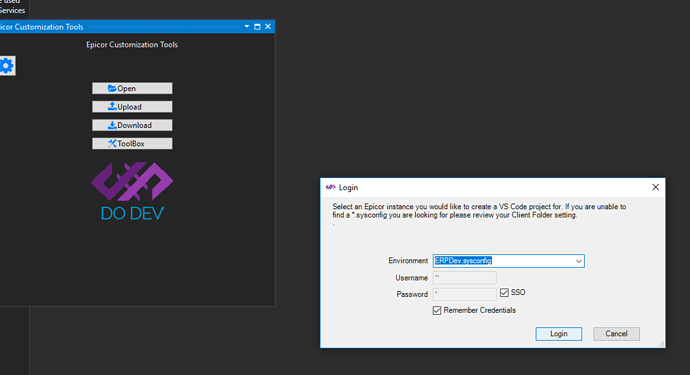

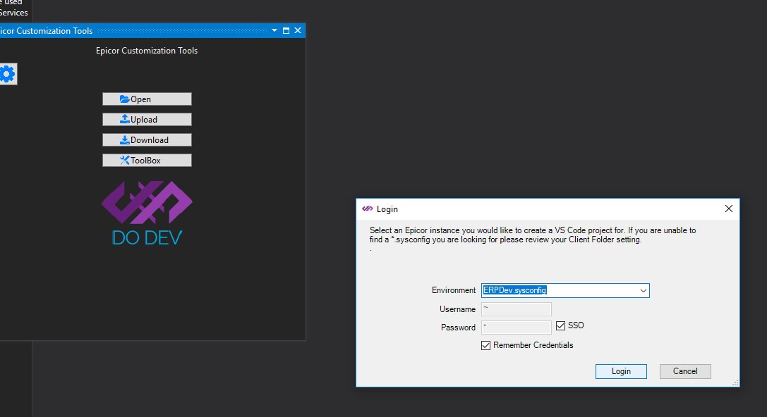

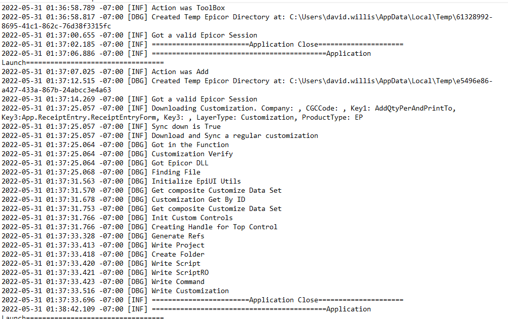

I can open a customisation, but when I click on âToolBoxâ nothing happens.
How can I debug this?
