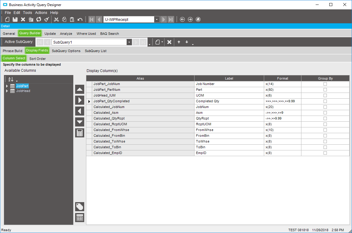

By the way since you have a dynamic object you can address the fields by name not sure if you knew… but you can do
foreach(dynamic d in data.value)
          Console.WriteLine(d.Calculated_RcptUOM);
It won’t auto complete cause well it doesn’t know ahead of time but it will work
