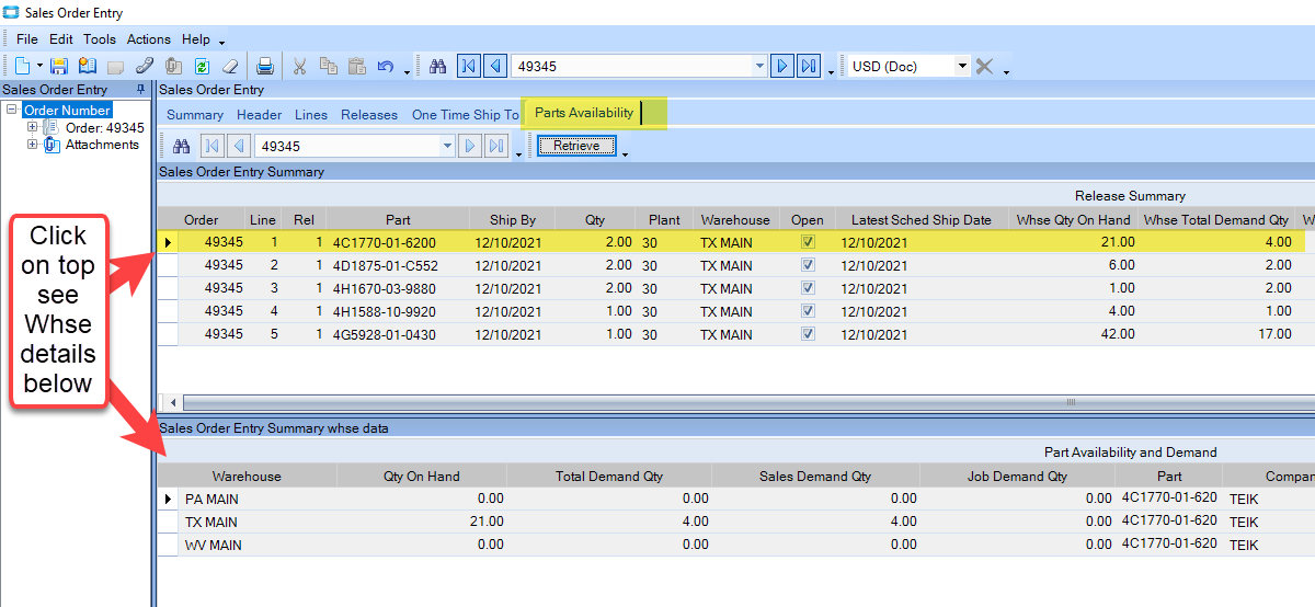

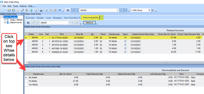

We have a “parts availability” tab via embedded dashboard that shows users part QOH in multiple plants in our company. We store inventory in multiple plants for some parts and determining where to ship from can be a combination of geography as well as part availability. We do default based on the product group sales plant for many of the parts. But sometimes it is better to ship from a plant that has all on hand. Our users provide positive comments on this customization frequently.
Nancy, I appreciate the suggestion. My mind also went to using some sort of dashboard. I like that you made yours in sales order entry and the fact that it uses data from the order to give a more detailed picture of the part availability- pretty slick!

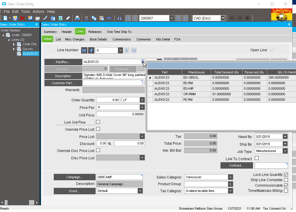

We created a BAQ and set it as a Zone BAQ for the OrderDtl.PartNum field in Extended properties. This lets us know at a glance what warehouse has Qty regardless of the site.
