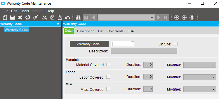

Service Management -> Field Service -> Setup -> Warranty Code
Warranty code master will be created here, indicating Material / Labour / Misc. covered.

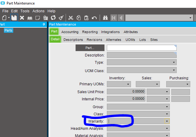

The above defined codes can be mapped to parts in the part master.

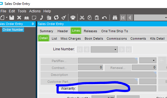

While booking sales order the warranty gets defaulted based on the part master

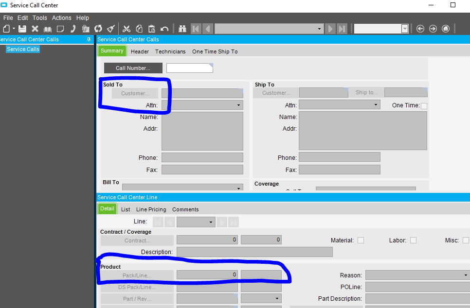

user service call center to record the details.
Service Management -> Field Service -> General Operations -> Service call center
Select the customer in the header
Select the Pack / line which will list the shipment done against all order for the selected customer
Create service job against the call

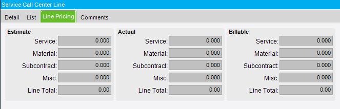

Issue any material required and labour time entry.
This will help you to record any cost associated.
Line pricing in the service call center will give an idea
